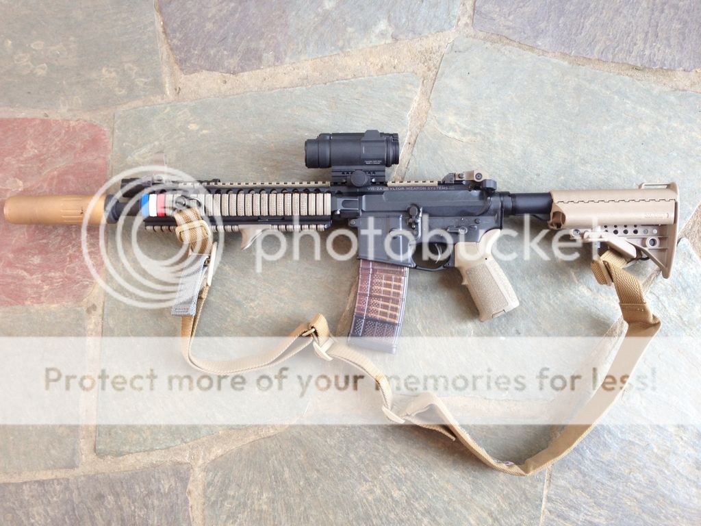

My gun:
DD 12.5"
lo pro pinned
A5 kit with A5H2 or A5H3 buffer
Nickle boron bcg
forged upper/lower
Surefire socom flashhider
6.6lbs unloaded
I just finished up a class this weekend with Magpul. Of the 8 or 10 rifles there, mine CLEARLY had the most recoil. I have videos of Steve Fisher running his gun fast, and mine, there is a noticeably slower cadence with my gun. For anyone that doesn't know him, he's not a small dude. Probably not joking, at least three times my upper body size, I can see in the videos my gun is pushing him around a lot more than his gun (16" midlength, H2, battlecomp or tripletap)
Now, obviously, I have a carbine vs midlength, I have a flash hider vs brake, but even for the guy next to me running an 11.5" with flash hider, it's a noticeable amount of extra recoil.
My guess is that DDs run overgassed. Can anyone confirm? I won't get into BS ejection pattern, but I will say there are no obviously marks on my brass, and the ejection is quite predictable. If I had one to test, I'm almost certain this gun would easily run an A5H4 unsuppressed.
The next step is to use a MicroMOA gas block, but I haven't contacted them yet, so that isn't set in stone. I would be greatly looking forward to an adjustable block with a suppressed setting. I can't run the switchblock on my gun because of the NSR rail.
