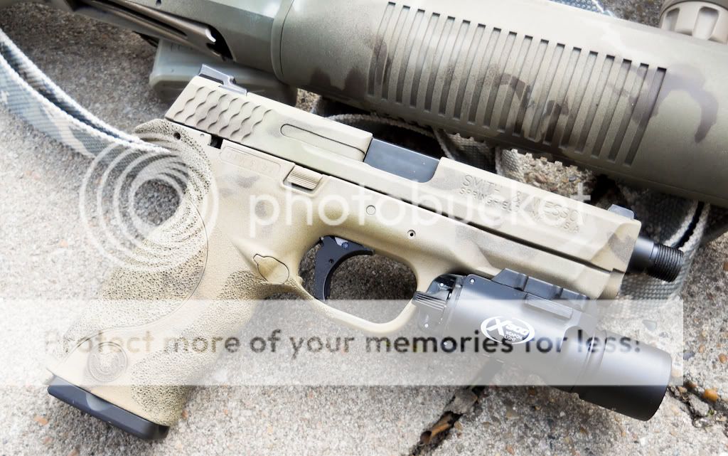

    To get it to look its best, use a Dremel sanding wheel. Once you get it close to where you want it, use a buffing wheel with a little compound. Be careful to go at a slower speed. If it heats up to much due to friction, out of nowhere you'll take out much more than intended.
    Here's one of the M&Ps I've done.
    This is a different one where I rounded the sides a bit more and didn't cut it out as much. Sorry these are M&Ps, but I'm content with my Glocks. $150 for just undercutting the trigger guard is a bit much, it's not a 1911.
