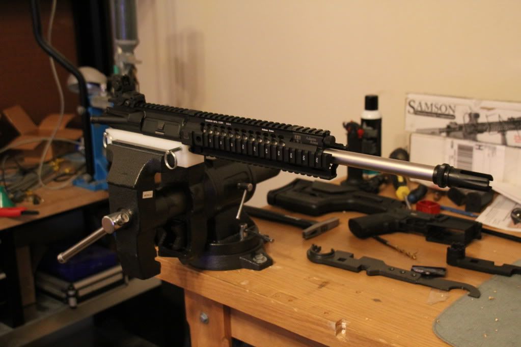

Gas Piston 300 AAC Blackout Upper
Building this new upper for hunting deer now that we can hunt game animals with suppressors in Texas.
Used the Adams Arms Gas Piston kit. Will allow me to turn off the gas for deer hunting to cut down the sound further.

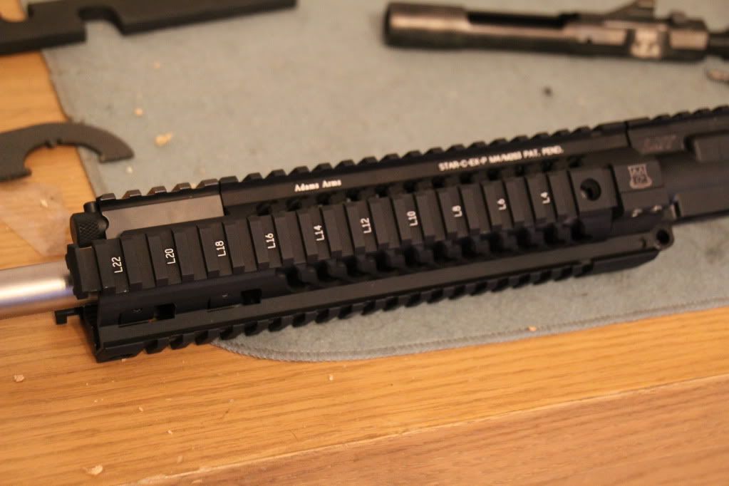

Samson Manufacturing makes these great hand guards that go around the gas piston system for Adams Arms.

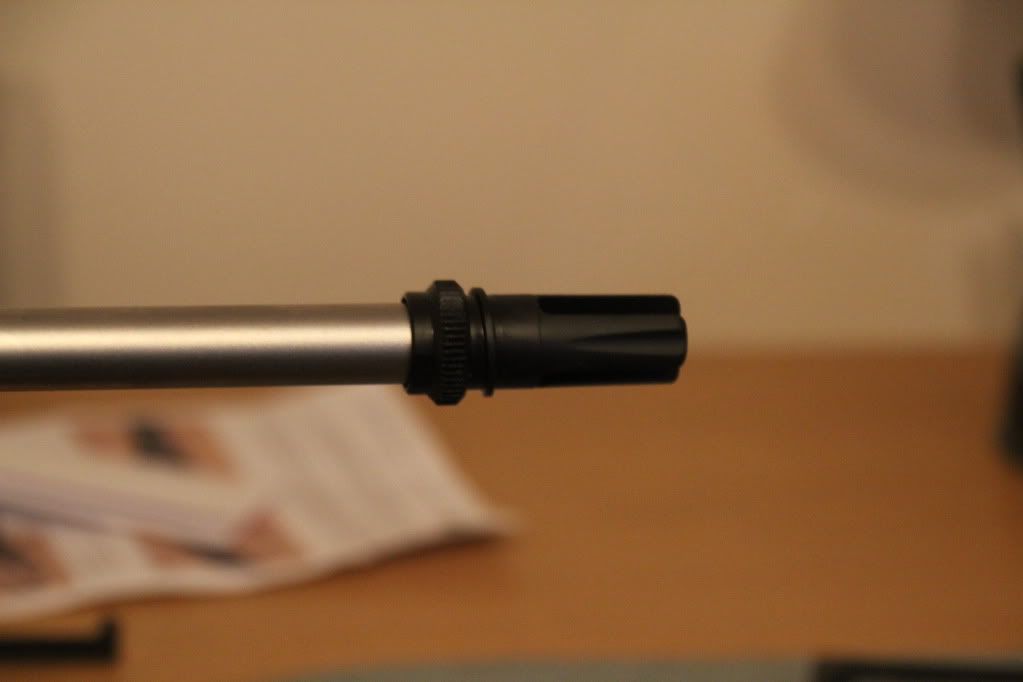

AAC Blackout Flash Hider suppressor mount for my 762SD suppressor.
Upper completed. Can't wait to shoot the gun. Will make a great hunting rifle.
LMT Upper Reciever
Wilson Combat Match Grade 300 AAC Blackout Barrel
Adams Arms / Samson Manufacturing Hand Guards

have you shot it yet? couldn't get mine to fully cycle even with the port opened up a bunch, had to switch back to gas.

I don't know of any company who's made a reliable piston .300BLK. The fact that LWRCs .300BLK is direct impingement is a "clue".

Still working on tuning. It runs supersonic ammo fine (suppressed only) but not subs. I have a low mass buffer coming for it today. If that doesn't work I suppose I will have to go back to gas which is pretty disappointing.

After trial and error and tuning it is back to the drawing board. There just doesn't seem to be enough pressure in the round to cycle the bolt with subs even suppressed. Time to pull it back apart and put in a DI system. I will use the Adams kit for a new 5.56 upper.

Just so everyone knows, this is now a DI gun. Even with low mass buffer and bolt carrier the 300BLK round just doesn't have enough pressure to run a piston gun. I guess I should have noticed that LWRCi's 300BLK upper for their PDW is DI. If LWRCi couldn't make piston work with 300BLK, I am not sure anyone can.
