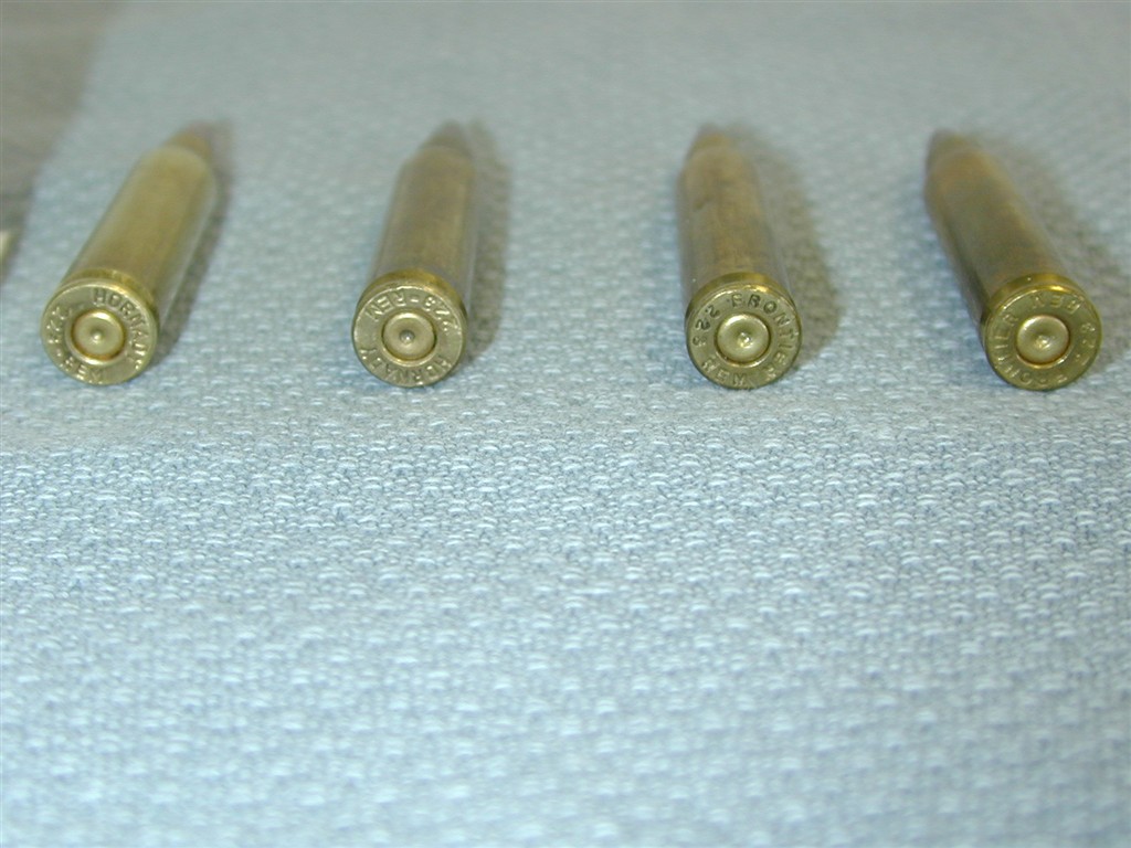

This past fall, a large SWAT team here had a failure to fire from an M4 with Hornady TAP ammo during an entry--fortunately no officers were hurt and the suspect immediately threw down his weapon when the carbine went click instead of bang. After the incident was concluded, the team went to the range and expended the rest of their carbine ammo and had one additional failure to fire. This same team had 3 Hornady TAP rounds fail to fire in training a couple of years ago. Last year, when Pat Rogers was teaching a class at a nearby agency, there were 5 failures to fire using Hornady TAP ammo. In all 10 cases, there appeared to be good primer strikes, but no rounds fired. On analysis, the ammunition had powder and checked out otherwise.
However, two problems were discovered. First, some of the primer strikes had insufficient firing pin indentations. The round from the potential OIS incident had a primer strike of only .013"—the minimum firing pin indent for ignition is .017". In addition, the primers on the other rounds were discovered to have been damaged from repeated chambering. When the same cartridge is repeatedly chambered in the AR15, the floating firing pin lightly taps the primer; with repeated taps, the primer compound gets crushed, resulting in inadequate ignition characteristics--despite what appears to be a normal firing pin impression.
Since then two additional AR15 failure to fire episodes have occurred with other SWAT teams around the country during OIS incidents, with other brands of ammo.
The Army is also aware of this problem and put out the following guidelines in the fall of 2008 to limit re-chambering to 5 or less times (4 times too many in my book...):
The current military fetish on constantly loading and unloading creates more problems than simply leaving the weapon "hot".
Re-chambering handgun ammo can also cause problems due to bullet set back and damage to the case rim from repeated extractions.
Bottom Line: Once a round has been chambered, DO NOT RE-CHAMBER IT AGAIN for duty use--relegate it to training only. This is CRITICAL!!!
