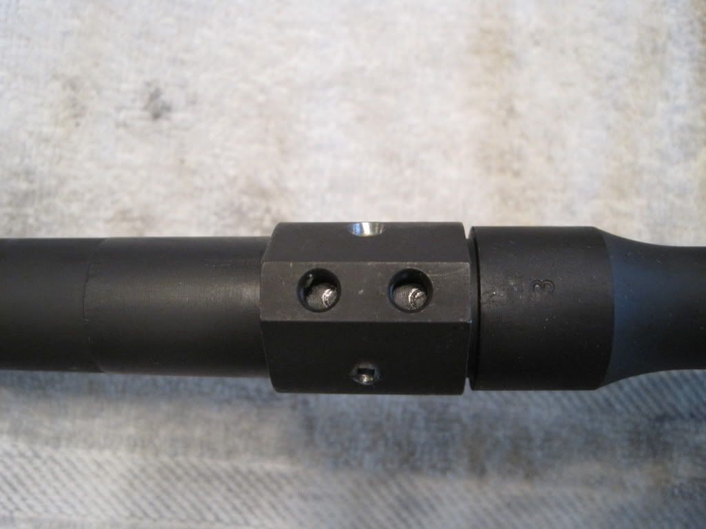

Update, well my friend said he was confident in me diving in to the rifle a little more. So I took it down and looks like we solved the issue. Gas block. Thanks for the help guys.
The retaining screws on bottom were very loose.
http://i300.photobucket.com/albums/n...n/IMG_4976.jpg

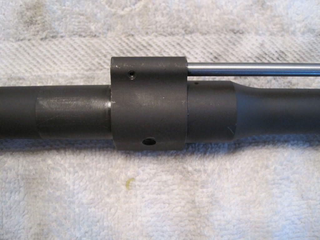

http://i300.photobucket.com/albums/n...n/IMG_4977.jpg

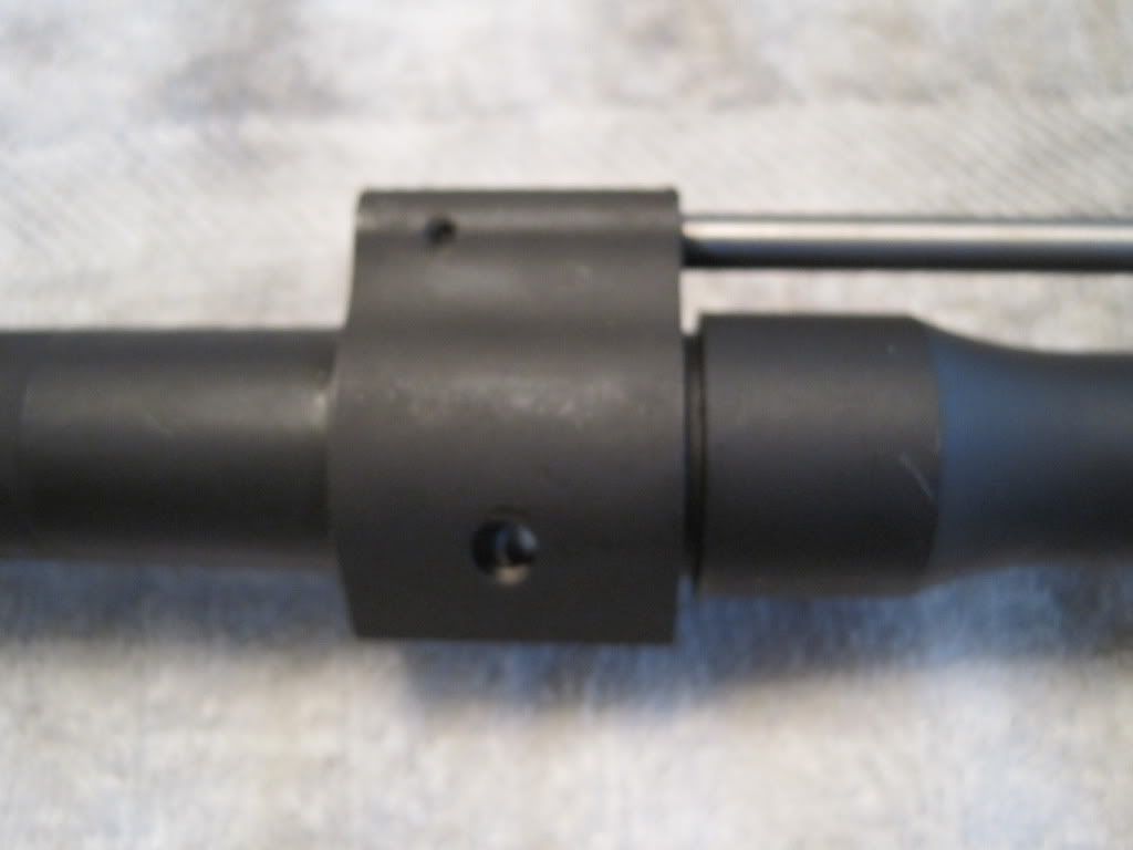

Moved it back and put loctie on the screws.
http://i300.photobucket.com/albums/n...n/IMG_4978.jpg
http://i300.photobucket.com/albums/n...n/IMG_4979.jpg
