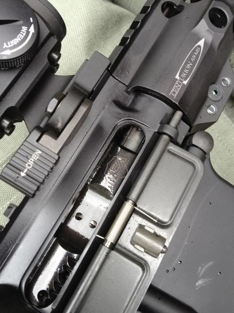

I ran it on Memorial Day weekend as a new carbine build, with 150 rounds with zero issues. This week, I installed a Centurion CMR rail and Parallax gas block. I took it out for a 4th/July shoot expecting similar results.

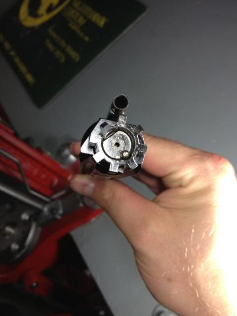

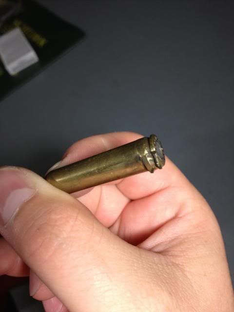

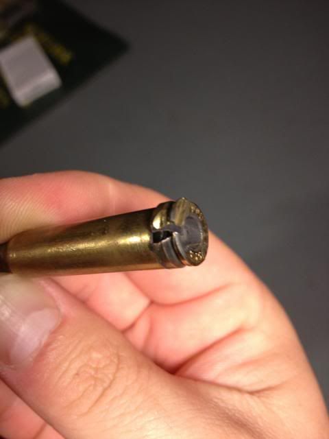

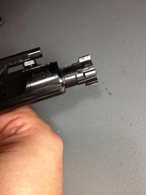

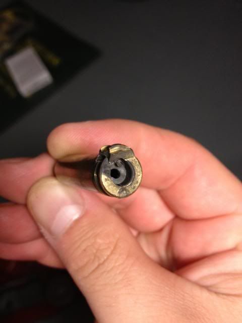

I experienced a seriously critical failure 7 rounds into the session. I fired 4 rounds from one magazine (was confirming zero changes on the Aimpoint sight) without issue. I loaded 4 rounds in a second magazine. 2 fired without issue or consequence. The third round, detonated before the bolt carrier was fully seated and the bolt fully rotated back in place The bolt itself was fully engaged in the lugs of the barrel, however, as I said, it detonated prior to full BCG seating.
http://i163.photobucket.com/albums/t...ps7abe522a.jpg
This was a RH rifle, and I am a LH shooter. I received a great deal of smoke and/or gas back into my face. Thankfully, I am none the worse for wear.
The BCG remained stuck in an unclosed position. The case was stuck in the chamber. I was able to remove it by force via a dowel in the barrel and a rubber mallet.

Upon cleaning and oiling for an experiment only (with proper safety equipment), the rifle and BCG chambered a round perfectly, fired, and he BCG returned to strip the next round in the magazine, however it was trying to chamber it on top of the fired case that never extracted in the first shot.

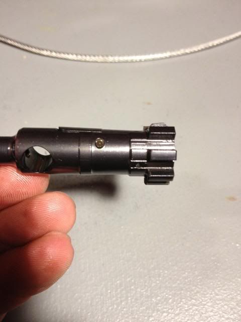

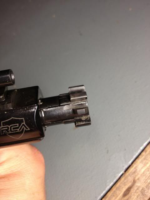

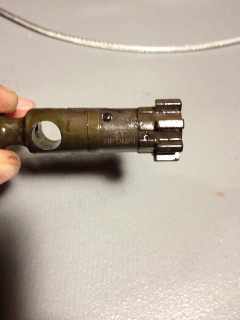

After again removing the BCG from the gun, I can easily notice that the extractor appears to be toasted. There are visible and physical cut/wear marks on the external side of it, and the tension is almost completely gone.

At this point, I'm unsure of what exactly caused this issue. I have shot this barrel/BCG before without issues. I have used this ammo before (PPU XM855) with great results. I have used the Lancer AWM L5 20rd mags before without issues.
Here is a shot comparing the bolt to a Spikes bolt to show the difference in extractors:
http://i163.photobucket.com/albums/t...ps651b6db4.jpg
http://i163.photobucket.com/albums/t...ps04cb135e.jpg

Please help me troubleshoot or understand what the issue could be here. Is it as simple as the extractor? Should replacing the extractor and guts and/or the entire BCG fix this? Or could there be more involved?
