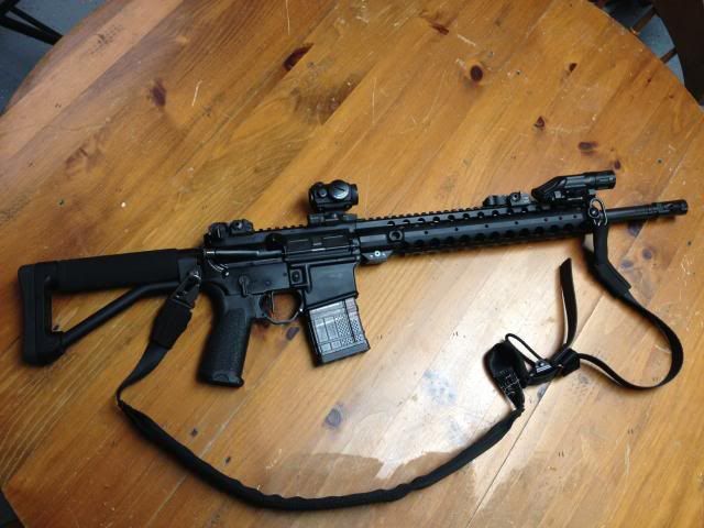

The BCM barrel is a VERY fine piece. Machining is beautiful, and the IonBond is done right. It is a little heavier barrel, but I almost think it balances a little better. This time I mounted a BCM Comp Mod 1.0 on the barrel as well.
http://i163.photobucket.com/albums/t...ps493a271b.jpg

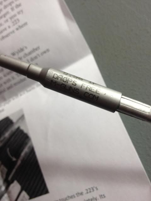

Today I received the chamber gage from Michiguns. After work I immediately went down and pulled all of my barrels to check them with it.
Drop the gage in the chamber. Turn barrel upside down, and see if gage drops freely. If it drops freely from the chamber, or can be removed from the chamber with no resistance, or spins freely - 5.56mm NATO chamber. If it does not drop free, does not spin freely, does not remove without resistance - less than 5.56mm NATO chamber, and possibly .223 REM or somewhere in between.

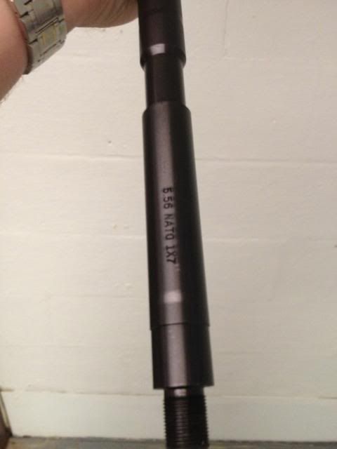

Mossberg OEM 1x7 5.56 NATO Melonite Barrel:
http://www.aimsurplus.com/product.as...el&groupid=573

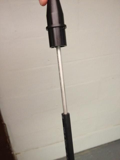

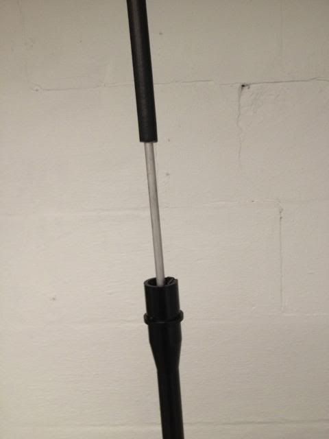

This barrel did not gage correctly as 5.56mm NATO. Gage did not drop freely. Did not spin freely. Removal encountered resistance.

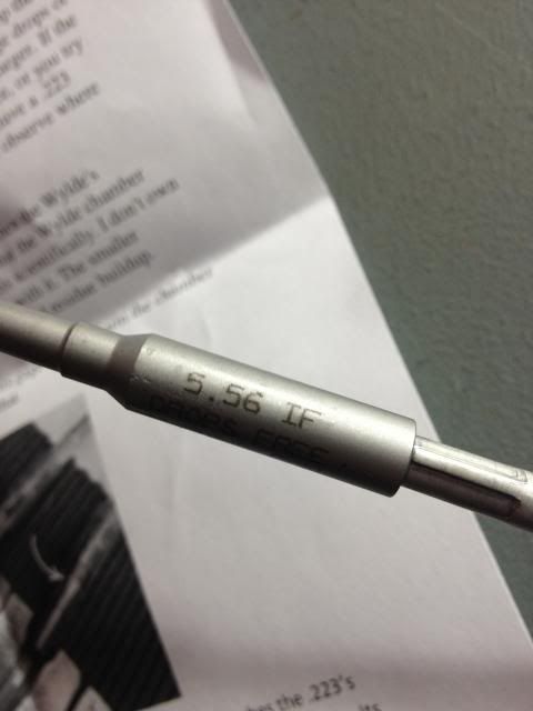

Pics of gage:
http://i163.photobucket.com/albums/t...ps305903a2.jpg
http://i163.photobucket.com/albums/t...psc44ea3fa.jpg
Pics of gage in barrel chamber:
http://i163.photobucket.com/albums/t...ps40816328.jpg
Barrel marked as 5.56NATO:
http://i163.photobucket.com/albums/t...ps654a3bd0.jpg
Gage does not drop freely from barrel:
http://i163.photobucket.com/albums/t...ps1f27234a.jpg
