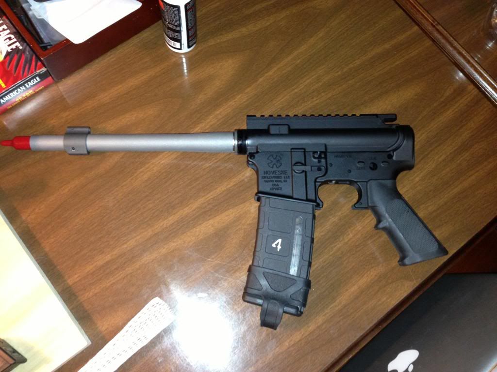

I was putting a Noveske barrel into Noveske stripped upper and it was extremely tight. I hit it with a rubber mallet a few times and seated it just fine but it was about a 5min process getting the barrel seated in the receiver (i put a layer of SLIP EWL over the extension to try to facilitate the process but it was still pretty difficult). A friend suggested using a lapping tool... I didn't think this was a good suggestion. What is the general consensus on these? Necessary? Any performance advantages?
http://i1366.photobucket.com/albums/...ps77e8dfac.jpg

My 6.8 ARP barrel was the same way. I used a trick I use on bearings. I put the barrel in the freezer for a couple hours. Once it cooled to -10F, I tossed the upper in the oven set at 225* for 15 minutes. They slid together just fine with that method.
Had to do the same thing with a barrel in a Vltor VIS
