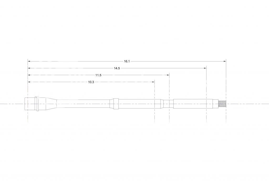

The barrel at the notch should be 0.61 dia - if you square off the tapered step at the back of the notch, then cut and thread the "notch" section of the barrel, you should come out with a barrel that is ~11.3 inches, measured from the bolt face.

Here is the M4 profile from Randall's site.

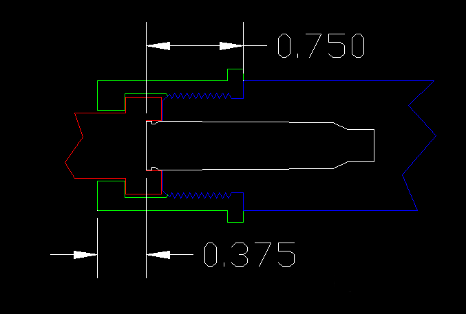

Add .75" to the lengths shown for actual measurements to account for the bolt face to shoulder dimension.
If you cut it at 10.625", the FH shoulder is at 10.000"
The total bbl length is 10.625+.750=11.375"
http://www.ar15barrels.com/tech/m4a1.jpg
http://www.ar15barrels.com/tech/ar15bolt-extension.gif
Here is the other option for a 12.75" bbl, the FH shoulder is at 11.375"
http://img822.imageshack.us/img822/8980/adco1.jpg
The answer to your question is yes. If your goal is to cut it short enough to eliminate the notch, it could be made between 10 & 11.3 inches.

If it's just cut and threaded at 11.5", you will still see some of the taper unless more machine work is done. Rguns sold cut-down Colt M4 barrels as Commando barrels in the past. It was pretty obvious.
I got one years ago and had Adco cut it to 10.3" and open the gas port to make a MK18 upper. Don't shoot it that much, but it's worked fine.

12.5" is a good length to cut it down to. I don't believe that the gas port even needs to be opened up if you cut it down to that length.
The measurements shown are breach threads to crown.

That is an excellent print. Thank you
