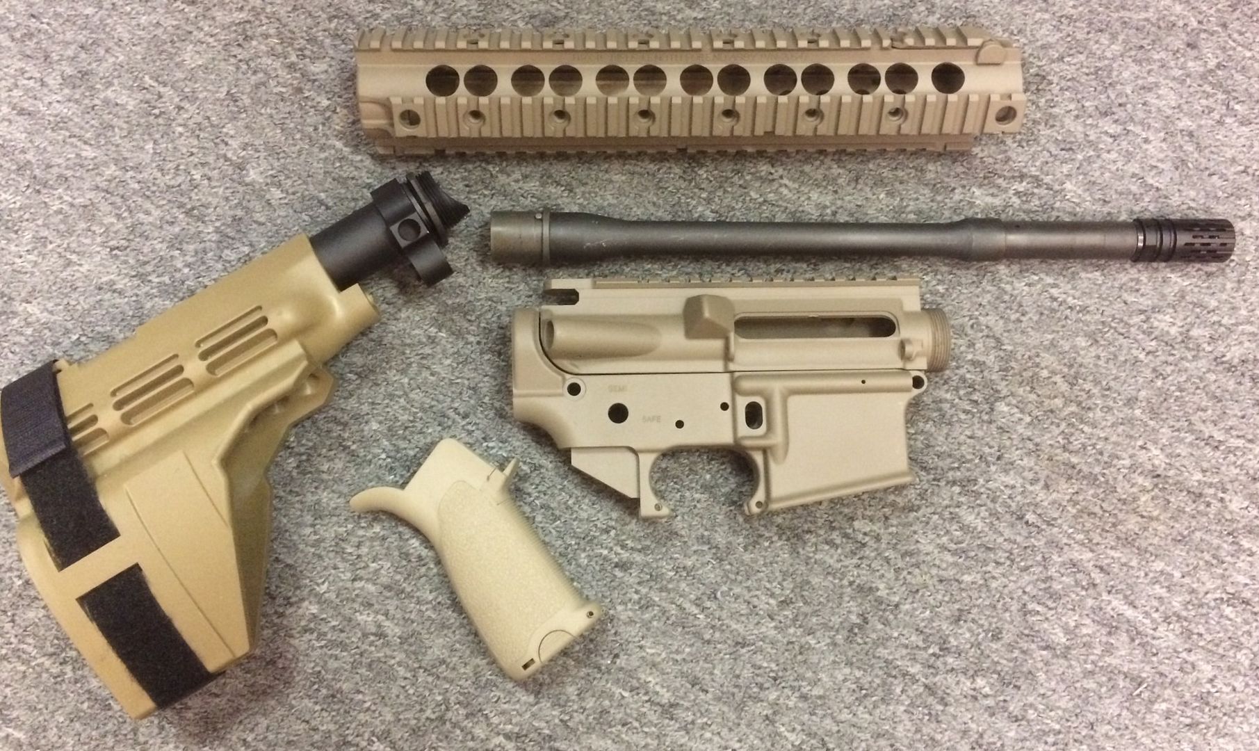

So basically I've got a BCM 16" mid-length upper and CMR 12" rail that's not being used.
Is there any reason why it would not function if I chopped the barrel to 12.5?
