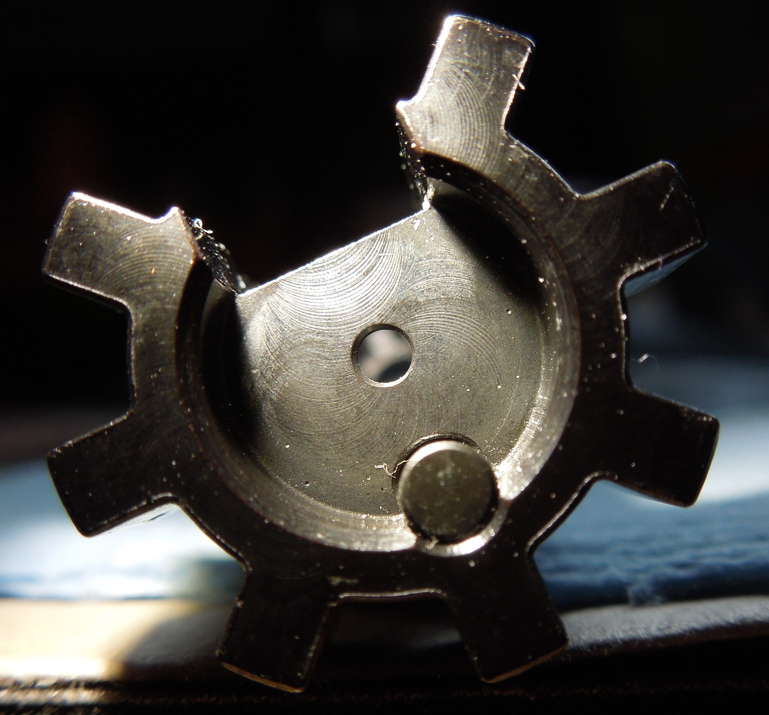

Decided to give Brownell's nitride 9310 bolt and BCG (for another gun) a try.
The lone bolt is worn endmill country tho, lol. The bolt from the BCG is better, and doesn't have that edge relieve cut raised burr around the lugs. Shouldn't shot peening have taken care of that tho?
Both pics are of the same bolt.
https://i.postimg.cc/QXvWvj4s/DSCN3212a.jpg
https://i.postimg.cc/GrFsSwkw/DSCN3213a.jpg
I find it interesting that there are already pits in a brand new bolt face, likely indicating their presence in the base material from the start.
