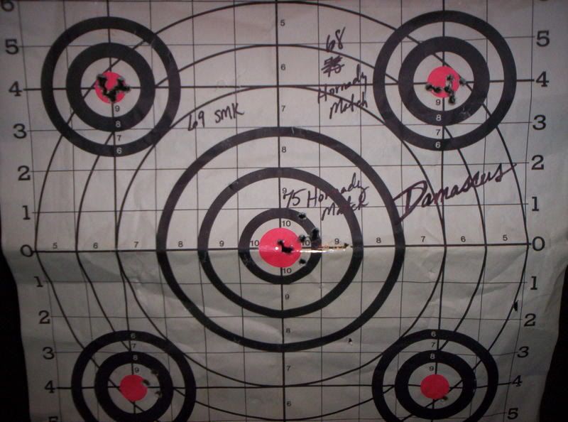

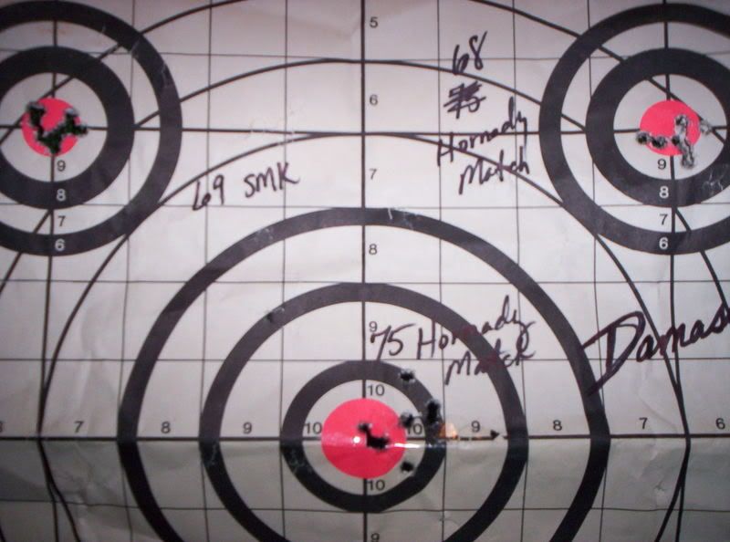

Check out these groups I shot yesterday doing some load development.
The 10 shot group on the top left is with 69gr. Sierra Matchkings.
The 10 shot group on the top right is with 68gr. Hornady Match BTHPs.
The 8 shot group (didn't have 10) on the center is 75gr. Hornady Match BTHPs.
http://i261.photobucket.com/albums/i.../Target_02.jpg
http://i261.photobucket.com/albums/i.../Target_01.jpg
All these groups were using my S&W, rounds loaded with various weights of Ramshot TAC, using CCI Small Rifle Magnum primers, and Winchester brass, loaded to a C.O.L. of 2.614" for all rounds. Shots were made from the prone position, off my Harris BRM bipod, at 100 yards, 60 degrees, no wind.
