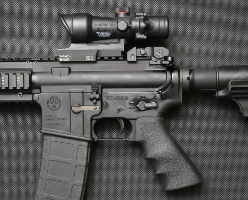

Based on the pics I see they aren't staking the castle nut. I also have not been contacted by Ruger as of yet in regards to the questions I posed. I was going to respond to the email they sent but it's a No Reply email.
This one my boss gave me to T&E. Wow the guy on SIGforum got it for a steal for $1499
With our standard mark up we will retail them for $1695.00

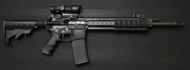

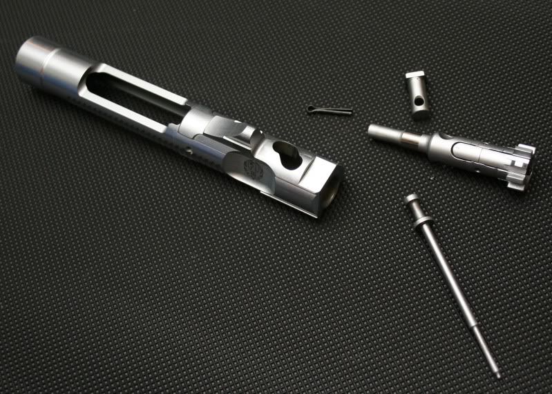

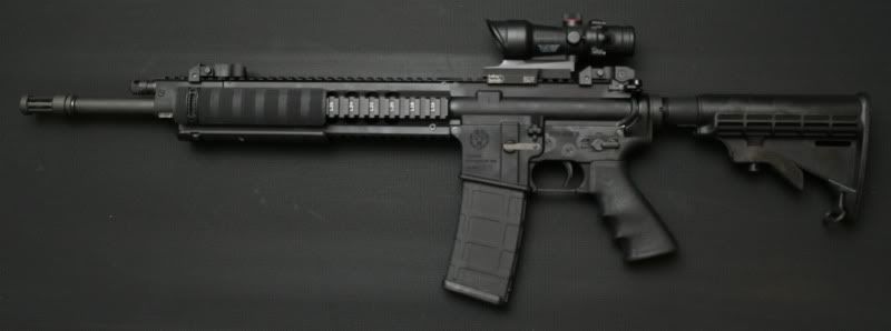

Somethings about the rifle:
1x9 twist (they're supposed to offer them in 1x7 in the future)
M4 ramps

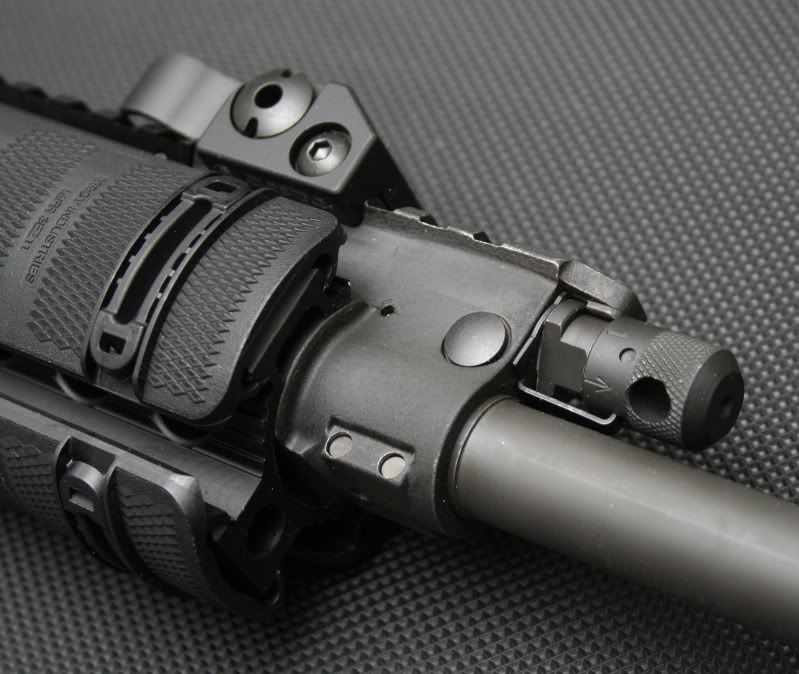

Mini-14 flash hider which has a crush washer so I'm guessing it's 1/2x28TPI and replaceable (I'll attempt this after some initial shooting)
adjustable gas regular (0 is off, 1-3 setting with 1 being the smallest)

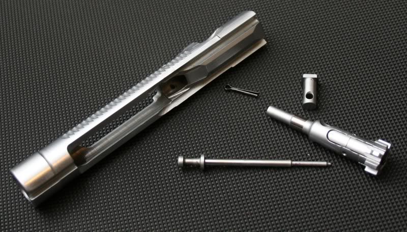

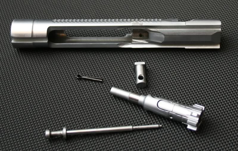

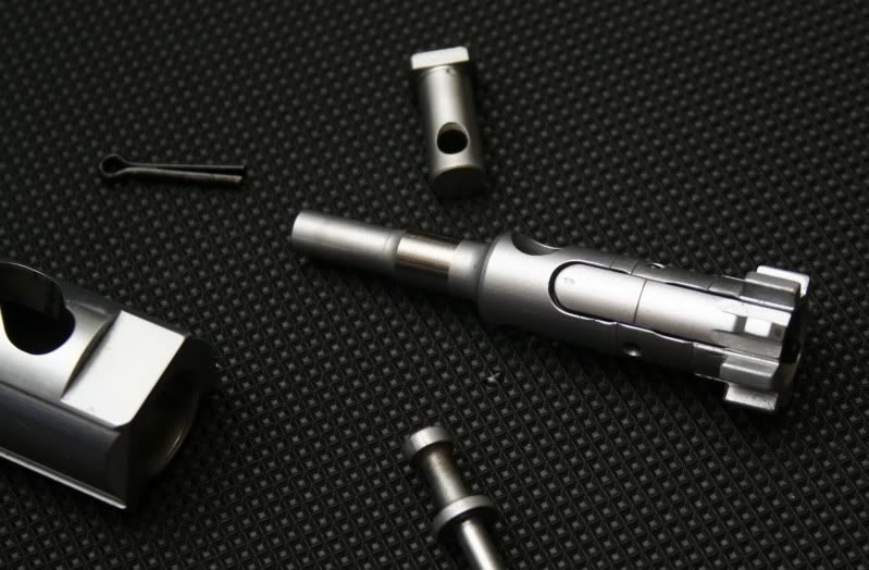

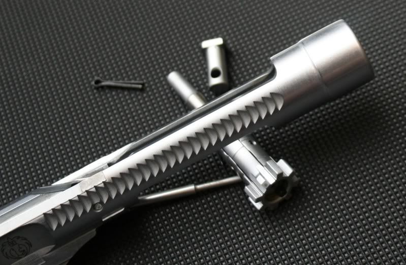

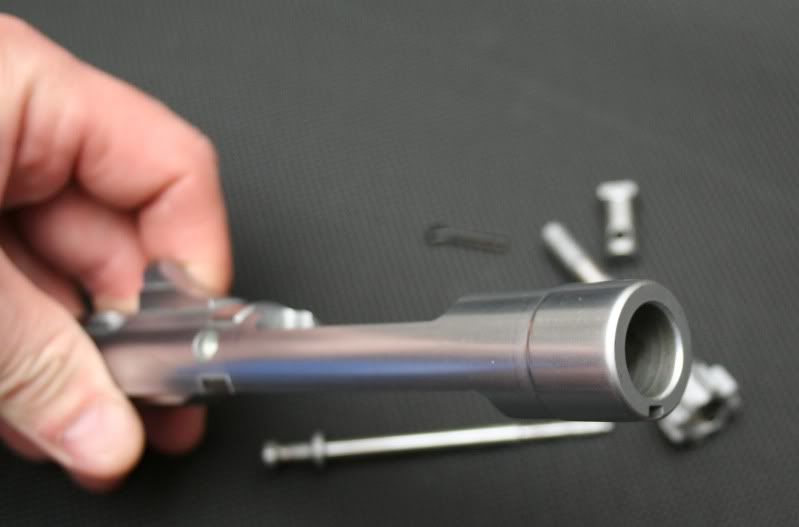

proprietary bolt (but uses standard AR15 cam pins, firing pins, extractors and ejectors)
3.0oz standard CAR buffer and standard CAR spring
midlength gas system or close to it (very long gas block which is pinned to the barrel)
mil-spec receiver extension (end plate not staked into the castle nut)
I don't know why they used a proprietary bolt. The stuff that's replaceable on the bolt are standard parts. The carrier is 9.0oz and is a non-shrouded type and semi-auto. I'll be testing the effectiveness of the adjustable gas system with some Radway Green ammo I have. This stuff runs in my Colt/PWS gun just fine and on setting 3 on this Ruger is should work. Ruger seems to have addressed the carrier tilt issue by making the back of the carrier slightly oversize and really beveling the rearmost edge of it. The surface of the entire carrier is very smooth, it appears to be hard-chrome after a real high polish. After some initial shooting I'll try my AAC M4-2000 Mod 07 on it with a Blackout mount. I'd like to try the new M4-2000 muzzle brake if they'll send me one.
Here's some pics. I'll be testing it using my Trijicon TA01 in a LaRue RCO mount.

Thanks for the write up and pics. I wonder why they did not make the carrier shrouded??

Meh. I was excited when these were first announced but I am tempering my enthusiasm at this point. Non Standard bolt Carriers, no staking, a few other small things like the FH. This may fall into the "Nice but I can build better for less" category.
