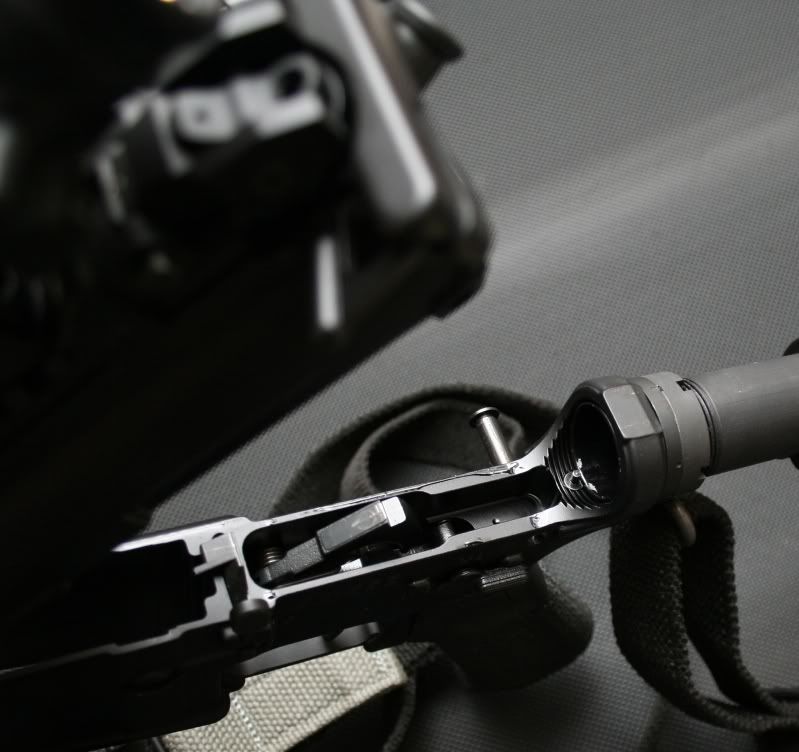

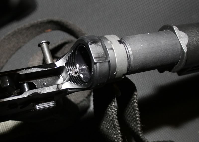

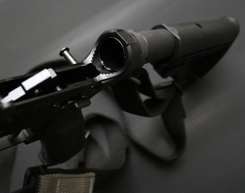

Could you take a look at the buffer tube and see if there is any signs of carrier tilt? Also, take a look at the inside of the upper (in the channel where a gas key normally rides) and see if there is any signs of the cam pin dragging?
Both of these are two of the common issues reported with AR piston guns, just wondering if they've been addressed by Ruger.

They are both present.
I've got just under 300 rounds through the gun now.

FWIW my Ruger already has finish wear just in the receiver extension just from Ruger test firing it at the factory. I haven't shot mine yet. Here's what is looks like.
Me thinks this thing is going to have carrier tilt issues unless one uses a Seth Harness anti-tilt buffer.

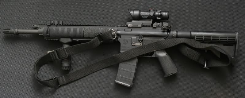

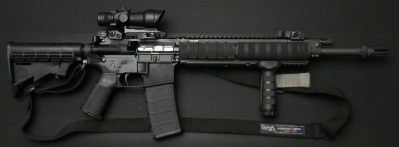

I changed out the lower receiver end plate for a used DD QD one I had, added a DD rail mounted QD point, a Vickers Combat Applications Blue Force Gear sling, a DD forward grip and some Magpul XT rail covers and ladder covers and a AAC Blackout M4-2000 flash hider/suppressor mount. Some of my co-workers (hunters and people who don't train nor compete) wanted me to leave it 100% stock. I asked how can I run drills that way? They looked at me like I was speaking a foreign language that they couldn't understand. Some people just don't get it...
