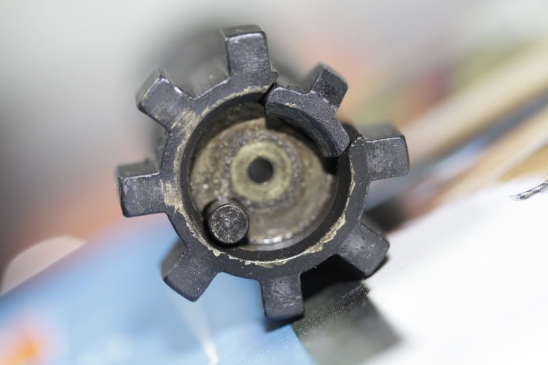

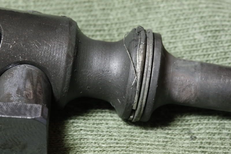

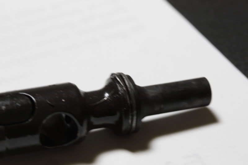

The first time I went to the range, I was shooting Monarch ammo, and after about 10 rounds, the bolt wouldn't seat all the way, and the firing pin wouldn't even touch the primer. The second time, after I replaced the gas rings, and cleaned everything out, I was shooting PMC ammo and got through about 25 rounds before I heard a *click*.

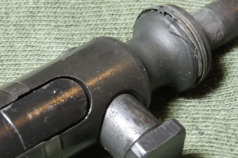

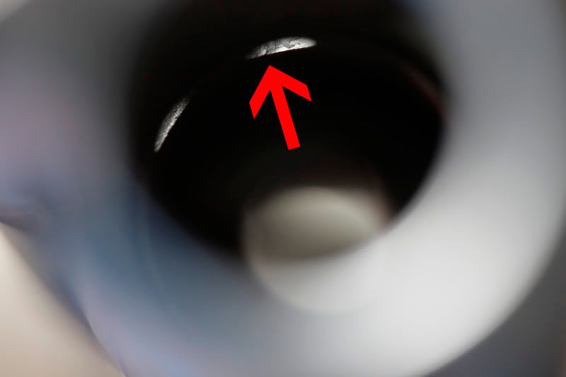

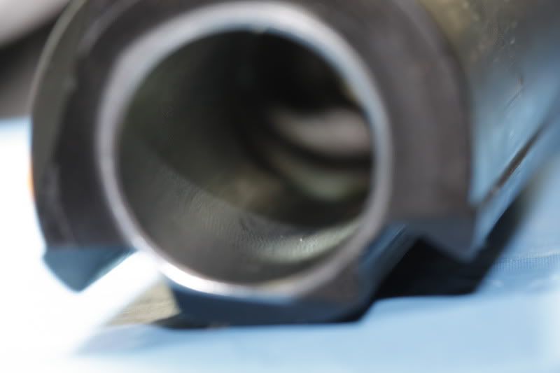

Here are some pictures:
1st time:
http://img.photobucket.com/albums/v6...t/_MG_4739.jpg
http://img.photobucket.com/albums/v6...t/_MG_4734.jpg
2nd:
http://img.photobucket.com/albums/v6...t/_MG_4744.jpg
http://img.photobucket.com/albums/v6...t/_MG_4745.jpg
As you can see, the damage is on the extractor side of the bolt and on the same ring both times. The pictures don't show this, but the damage is on nearly half of the gas ring, with the other side intact. Also, you can see a sliver of the gas ring starting to shear off.

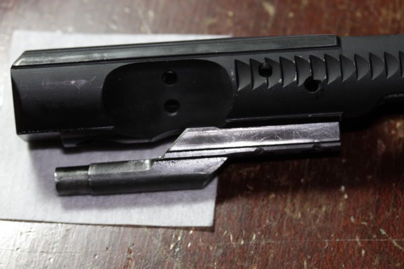

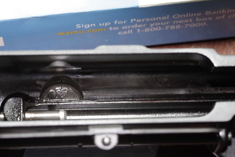

Also, when I disassembled the BCG, the cam pin took a great deal of force to make that quarter turn, and there is an indentation on the cam pin where it meets the edge of the bolt:
http://img.photobucket.com/albums/v6...t/_MG_4748.jpg
I've checked the inside of the carrier, and it looks smooth. Also, the closest thing to a gunsmith at the range suggested it might have been headspace issues, but when he looked at some spent casings, he felt they looked okay. When I said that the rifle was put together by me from scratch, he said maybe I just eff'ed something up, but a cursory once-over of the rifle revealed nothing glaring.
