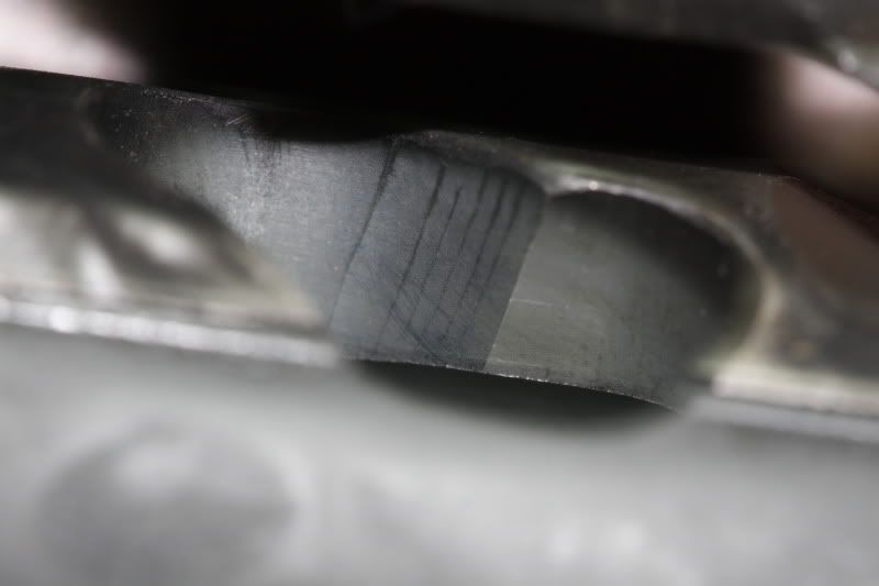

Wow! Lots more carbon on the charging handle than I would expect. I wish I could see the rifle! Do you have a pic of the chamber/barrel extension with the charging handle removed from the upper? The bolt face is remarkably clean. Is there any damage or score marks in the channel where the bolt cam rides in the upper receiver? What are you using for a buffer and spring?

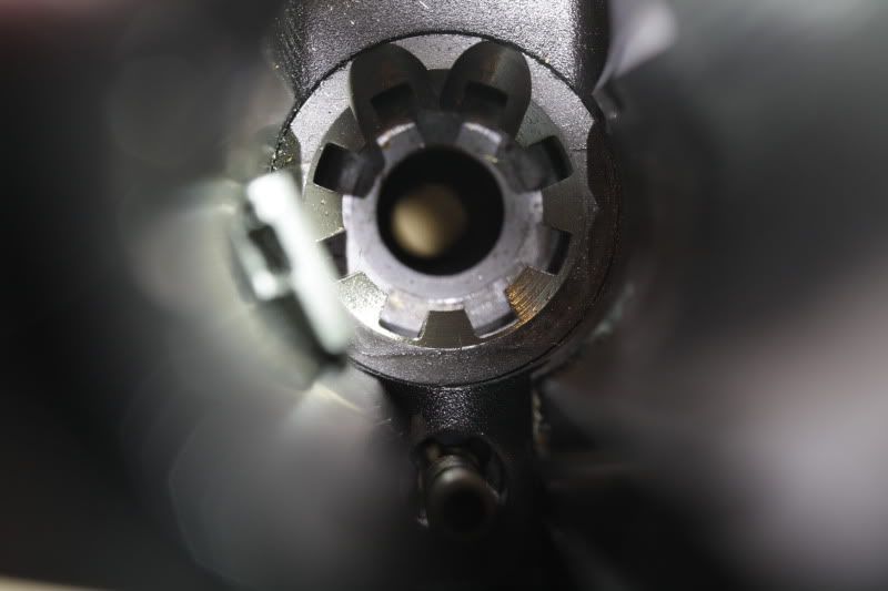

Looks like there are some score marks on the bolt cam channel
http://img.photobucket.com/albums/v6...t/_MG_4767.jpg
Barrel extension:
http://img.photobucket.com/albums/v6...t/_MG_4769.jpg

1. Where did you get the gas rings? Were they assembled onto the bolt?
2. Who makes the bolt, if known?
