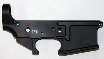

POF standard non-ambi lower
http://i134.photobucket.com/albums/q...f/416gen2a.jpg

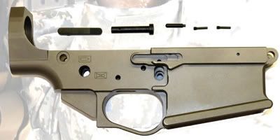

POF lower with Ambi release (note the extra cut above the magazine release button)
http://i134.photobucket.com/albums/q...ceiverspec.jpg
FWIW, I contacted ROBARM a while back about designing an AR lower with a XCR-style ambi bolt release. They said that they had some designs in the works.
