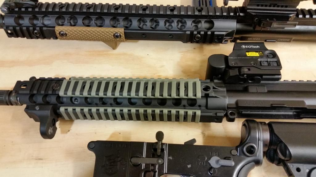

I picked up the barrel and upper from the Gun Gallery *years* ago. IIRC, Neil showed me how to install URXes with these parts. I didn't specifically pick out a black gas tube -- I ordered some and they came black. I won't complain though. :^)
Start with the stripped parts from the original upper. Started life with a URX 3 then later a URX 3.1 with an off-the-shelf (Troy?) low profile gas block.
https://www.boltcarrier.com/images/kac-lr-001.jpeg
Locate existing pin holes on the gas block, re-drill and ream for new taper pins. I used larger taper pins than the factory ones mainly because the tools were within arms reach.

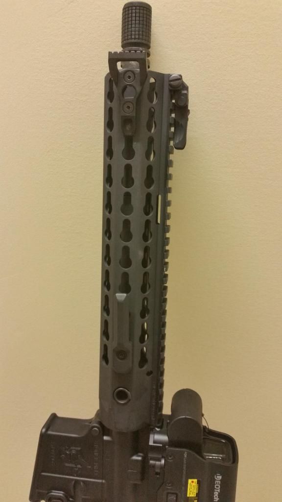

Re-install Ops-Inc collar and brake.
https://www.boltcarrier.com/images/kac-lr-012.jpeg
And ready to shoot today!
https://www.boltcarrier.com/images/kac-lr-013.jpeg
Mk12 Mod what? :^P
Is thread locker really necessary? The lock-up system is designed to put enough torque on the assembly that it will not come off. The system is very similar to any other rail that attaches to a torqued on barrel nut like the NSR, Geissele, etc. -- the obvious difference is that the rail and barrel nut are integrated.
