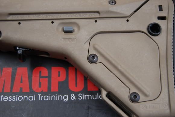

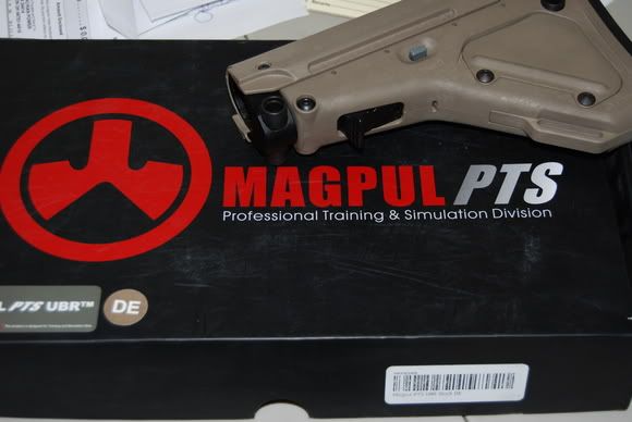

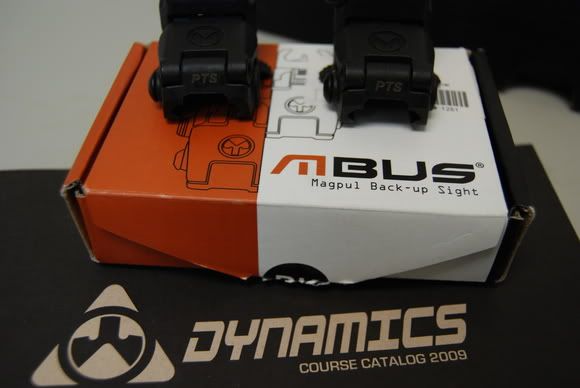

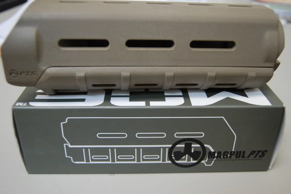

I'm not 100% sure about the MOEs, but the PTS CTRs and the PTS UBRs are NOT labeled as PTS on the actual stock. The box is the only thing that's labeled. The PTS MBUS are laser engraved "PTS" on the front of the sights. Hope this helps a little.
A few pics...
http://i117.photobucket.com/albums/o...3dsc_0530a.jpg
http://i117.photobucket.com/albums/o...z_dsc_0532.jpg
http://i117.photobucket.com/albums/o...z_dsc_0537.jpg
http://i117.photobucket.com/albums/o...z_dsc_0538.jpg
As you can see, the PTS MBUS and the PTS MOE handguard have markings, but the PTS UBR does not. The PTS CTR also does not. Be careful, but any reputable dealer will tell you which one you're looking at.
