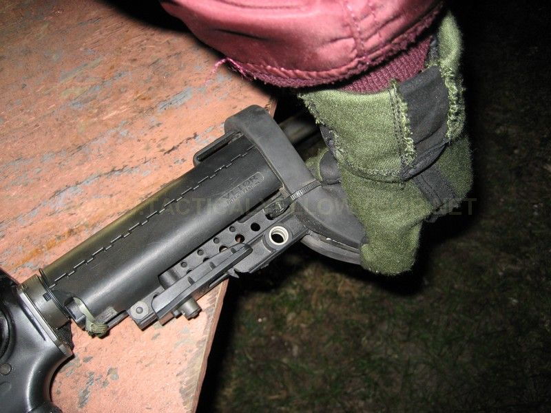

Suspected cause was a squib load, followed by immediate action, chambering a second round. Shooter was left-handed by firing from right shoulder. Magazine puked out the bottom, case head sheared off, case stuck in barrel removed with tools after the fact. Various states of disassembly shown were achieved at the range with minimal tools. Upper was removed from lower, rod was used to pound bolt back through bore, and then a screwdriver and heavy hammer were used like a chisel to pouch the carrier back to pull the bolt out of battery.

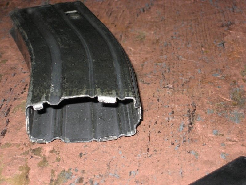

mag that puked

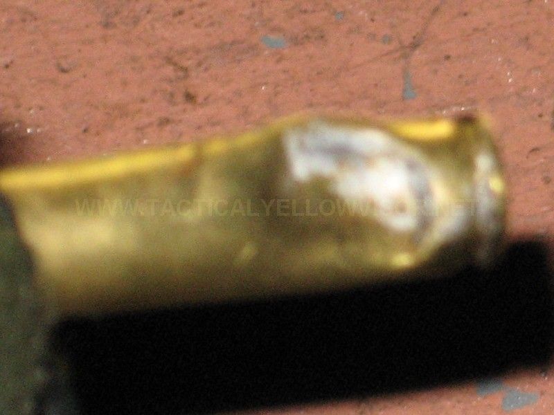

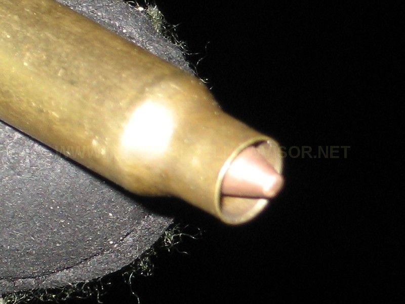

One recovered round
http://i134.photobucket.com/albums/q...P/IMG_1148.jpg
another recovered round (sorry for the blur)

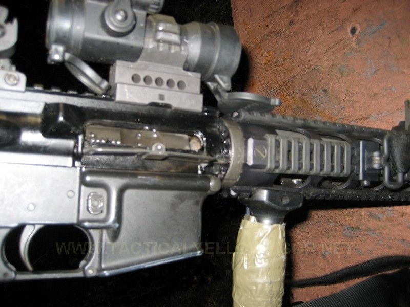

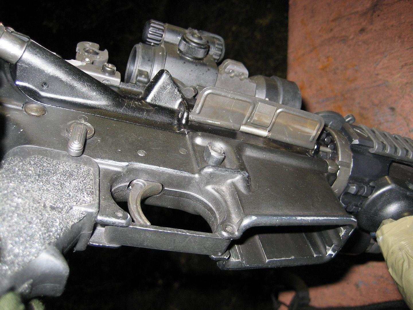

condition of carbine immediately following

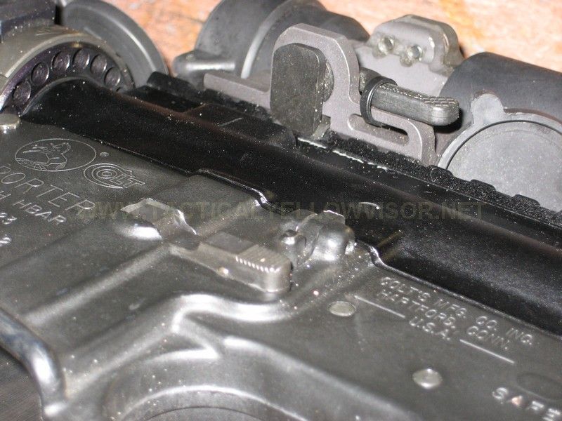

Upper receiver prior to removal of BCG
http://i134.photobucket.com/albums/q...P/IMG_1157.jpg

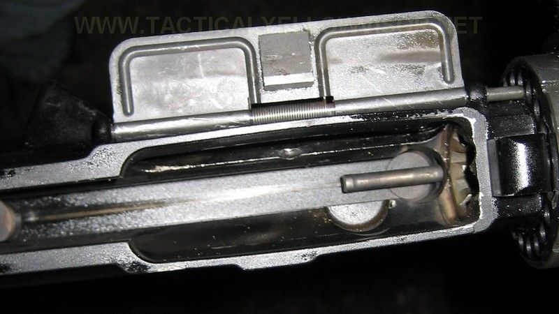

Upper receiver after removal of BCG

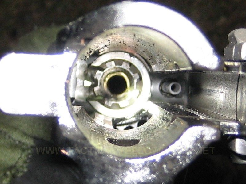

Case stuck in chamber

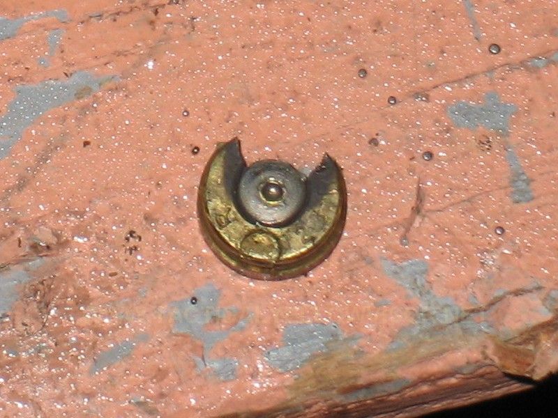

Head of case stuck in chamber

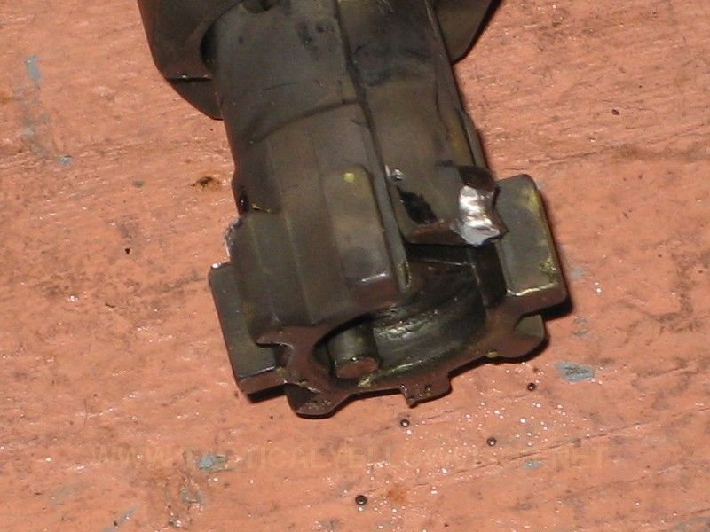

Extractor

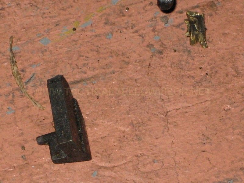

Bolt catch which sheared off (see above)

and remember kids, always strike the heel of the stock, not the toe, on the ground when mortaring
