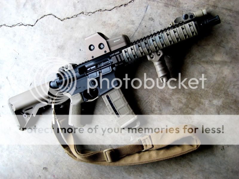

I am running an LMT 10.5" with that rail...
http://i977.photobucket.com/albums/a...8/8324a52e.jpg
