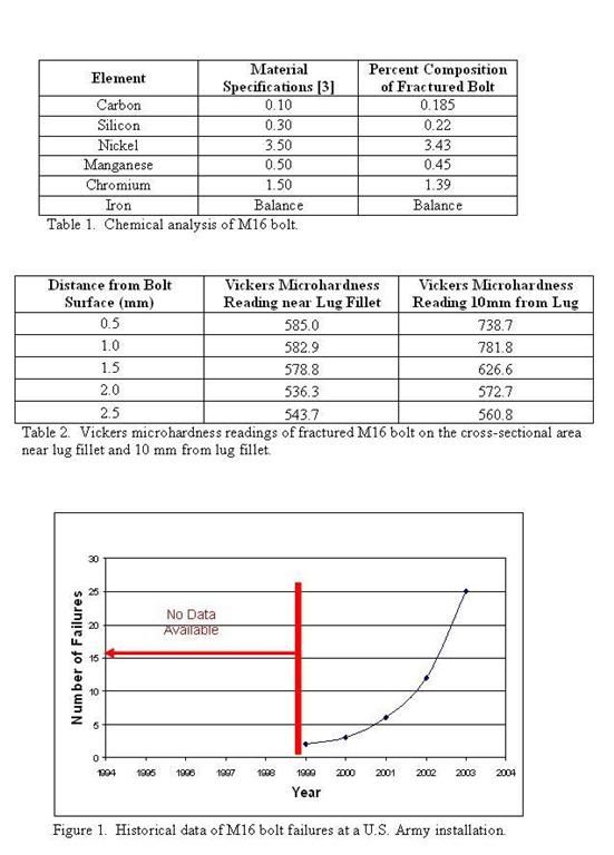

The M16 rifle was fielded into the U.S. Army in 1968 during the Vietnam War. The rifle has since been the primary assault rifle used by U.S. soldiers. The M16 has been through several modifications in its more than 30 years of service in the military. In July of 2003, an increasing trend in the amount M16A2 bolt failures was observed at a U.S. Army installation. Figure 1 displays the data of bolt failures observed over a five year span. These rifles were used over the past nine years during summer military training. As a result, this paper investigates the leading cause of catastrophic fracture of the bolt under firing conditions.

3a. Procedure. The M16 bolt was also analyzed from a metallurgical viewpoint. This analysis determined whether additional factors other than stress concentrations contributed to the bolt failure. A chemical analysis of the bolt was conducted to determine if the material specifications were met, as displayed in Table 1. A stereomicroscope and a SEM were used to locate the fracture origin and to evaluate the fracture surface.
Vickers microhardness indentation was performed on a cross-sectional area near the fillet of the lug and at approximately 10 mm away from the lug on the bolt. Indentation profiles, consisting of five indents for each location, were taken which started 0.5 mm from the surface of the bolt and proceeded inward every 0.5 mm. Hardness readings are shown in Table 2.

Chemical analysis of the bolt composition revealed no significant differences between the failed bolt and Carpenter Steel 158 specifications [3], as shown in Table 1. Micrographs from a SEM revealed that the M16 bolt experienced corrosion in the form of localized pitting, as shown in Figure 7, near the locking lugs adjacent to the round extractor. From the SEM micrographs, the circumference of the fracture surface of the ruptured locking lug possessed shear lips. The existence of the shear lips signified ductile failure at the surface. However, the region at the corrosion pit did not have this characteristic shear lip. The absence of the shear lip at this location indicates that the bolt material was discontinuous at the surface. This discontinuity suggests that the corrosion pit is where failure initiated. The corrosion pit provides an additional stress concentration which aids in the initiation of the crack. In addition, the SEM micrograph displayed the presence of chevrons as seen in Figure 7. The chevron markings point back to the localized pit which further confirmed that the pit was the site for crack initiation.

The Vickers microhardness indentations taken at both locations show that the hardness reading is higher at the surface than towards the center of the bolt. This demonstrates that the surface was case hardened. However, the Vickers microhardness at the surface near the lug’s fillet was 100 units less than the hardness readings 10 mm from the fillet region. This indicates that the bolt was not uniformly case hardened. Thus, the softer region near the locking lugs is more susceptible to wear.

The wear observed in the controlled experiment indicates the mechanism of why the corrosion pits formed near the locking lug fillet by exposing the Carpenter Steel 158 base metal to the environment. Vickers microhardness readings near the fillet region show that the bolt was not uniformly case hardened. Comparison of the microhardness readings near the fillet region and 10 mm from this region show a disparity of approximately 100 units. The softer, less carburized region near the fillet contributes to the formation of a wear area after firing just 1800 rounds.
