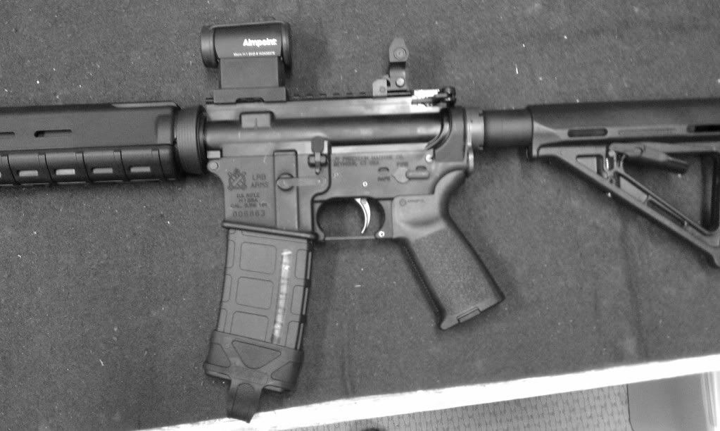

Eye candy...
http://i219.photobucket.com/albums/c...e/IMAG0071.jpg
Thats a very informative post, thanks
