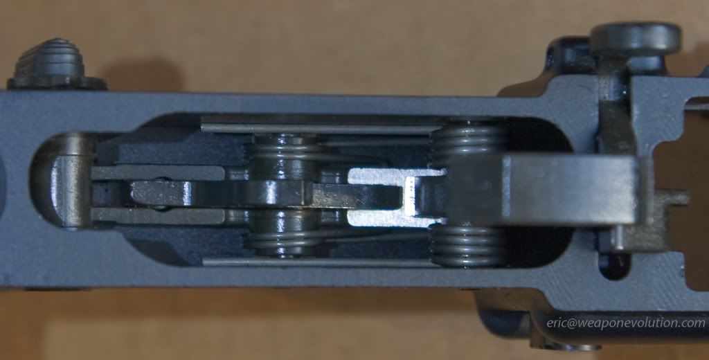

Just from this little info, it sounds plausible that your hammer spring is not resting on your trigger pin like it should. The legs of the spring should be riding in the grooves of the trigger pin, capturing it in place. Being that your lower is not a factory build (self built?) that would be my guess. KNS pins really don't solve anything more than in-spec and properly assembled parts do.
The hammer spring should be positioned like this.
http://img.photobucket.com/albums/v5...e/IMG_8295.jpg
Problem solved, I had the hammer spring on upside down. Thanks for the replies gentlemen.
