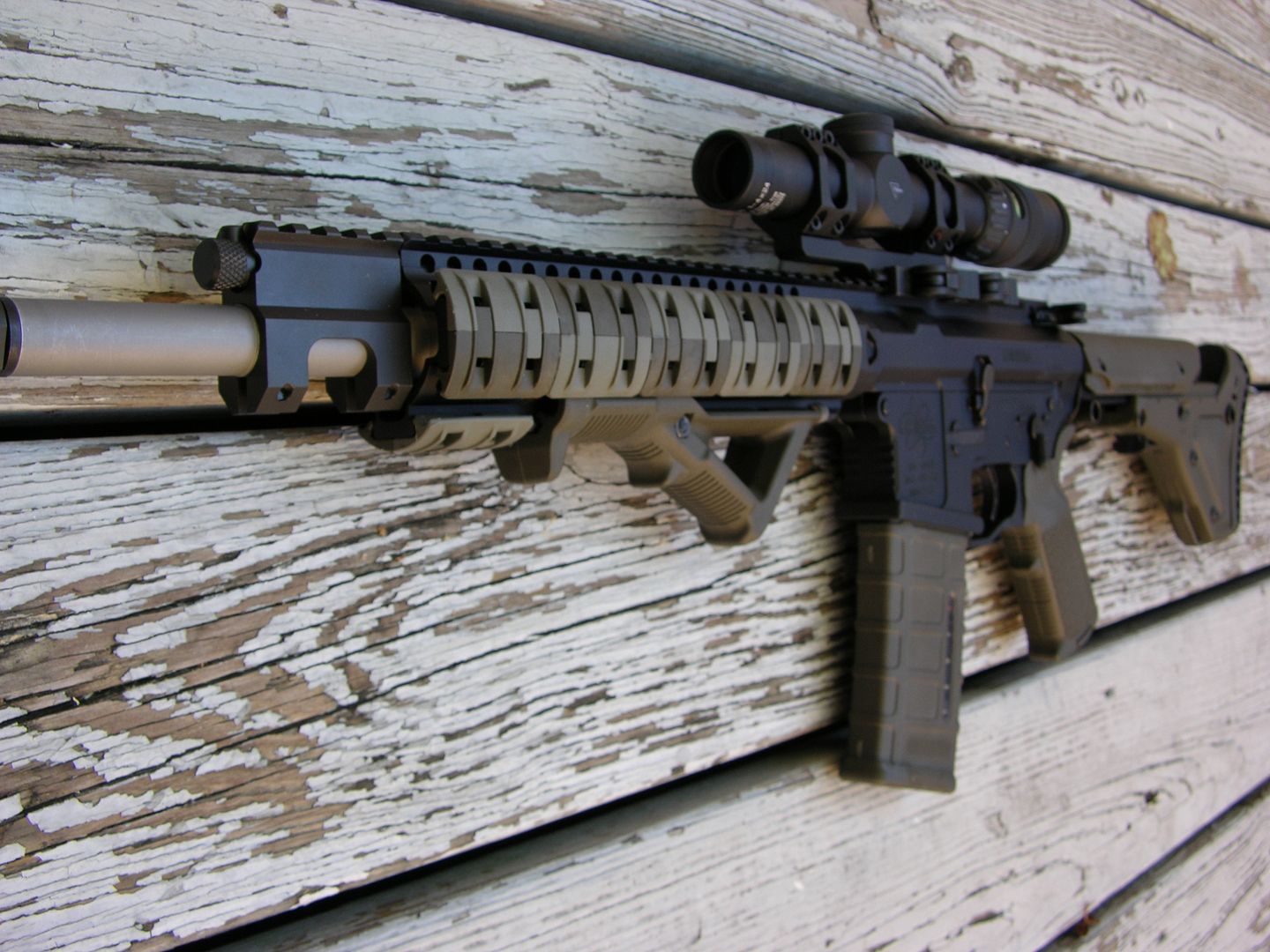

My first Mega build was the GTR-3H mated with the MTS- quadrail.
I have a second in progress destin to become a SPR.
pic of the fist one.
http://i105.photobucket.com/albums/m...R/DSCN2415.jpg
http://i105.photobucket.com/albums/m...R/DSCN2427.jpg
