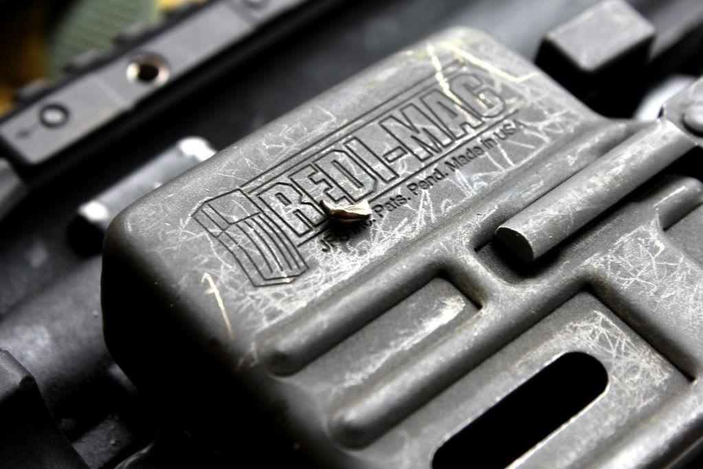

Bottom line, I could not for the life of me, see what the issue was. In the end, had to disassemble the rifle. Got out my tool kit, took off the stock, castle nut, removed the buffer tube, being careful since the buffer spring was compressed.
Once I got the buffer tube assembly off the rifle, I pushed the bolt forward and felt resistance. Looking all over the place with my pen light... I found the culprit.
http://i62.photobucket.com/albums/h1...%20Time/9i.jpg
Primer unseated out of the cartridge, and lodged between the bolt and the upper receiver. Very interesting stoppage... made the MIGHTY COLT stop in it's tracks.
I don't know if this is the proper forum for this post, if not... my apologies. I just wanted to share this stoppage.
I have encountered blown primers falling into the fire control group, but never wedging up between the BCG and the Upper Receiver.
