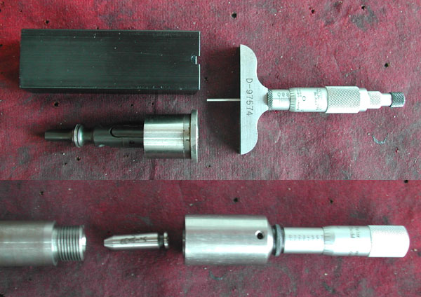

The only reliable way to measure is against the barrel's torque shoulder or by comparing against a known standard like a headspace gauge.
http://ar15barrels.com/tech/ar15bolt-extension.gif
Measuring from the rear face if the extension is not reliable as the length of barrel extensions can vary.
If you had a surface plate and a tall enough height gauge, you could work out the messurements from the front face of the extension.
This would be accurate enough to compare headspace dimensions as long as your bolts are roughly the same.
I have developed my own simple gauging tools that I use during chambering.
http://ar15barrels.com/gfx/gauging.jpg
