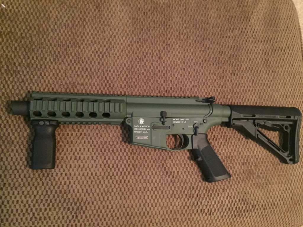

I did a 4.5" barrel, with the cut and thread handled by a local shop in the DFW area. Decided on that to keep bulk pack subsonic, and using my Sparrow, so the can would stick out a little bit.
http://i121.photobucket.com/albums/o...psv0i74dsw.png
I bought the Tacticool22 barrel tool, and cut the handguard at home, as a temp plan until I figured out the HG, but I dont know if I will make a change. Next up is to find a hand stop that I like better than the RVG.
Thus far I have ran several bulk pack ammo through it, not had a problem yet.
http://i812.photobucket.com/albums/z...psqyjwolp8.jpg

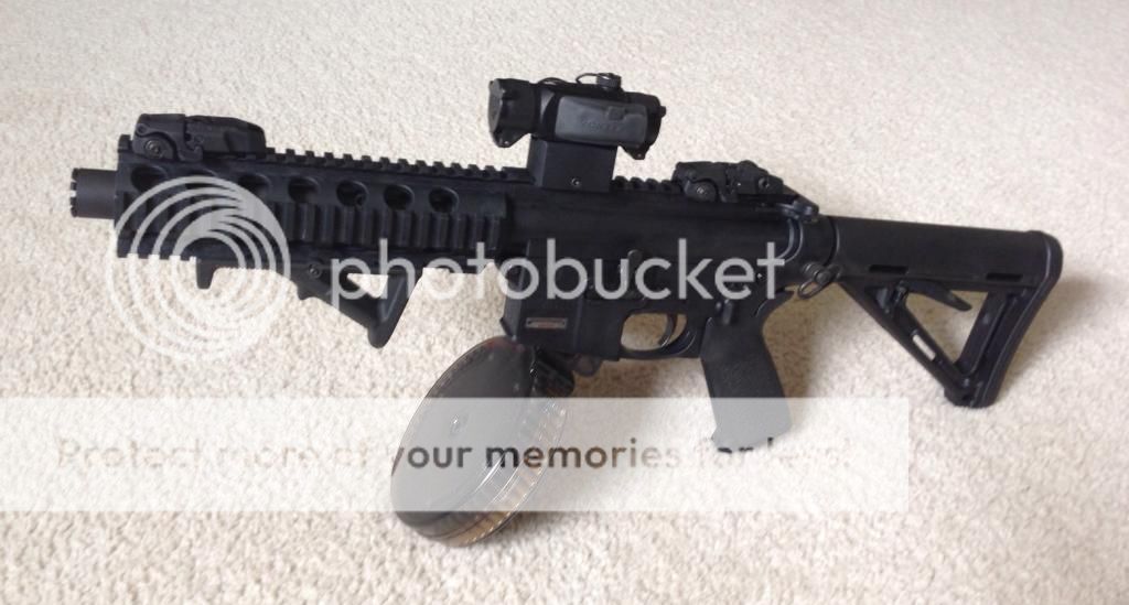

15/22 SBR, 7" barrel
SWR Warlock II can just peaking out of the handguard.
Runs like a sewing machine with CCI SV & AE 45 grain Suppressor ammo!
