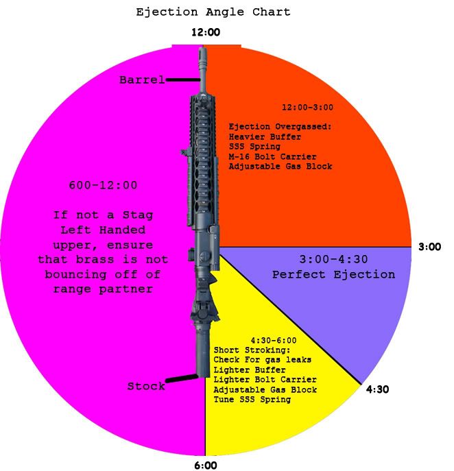

So I took various buffers and springs, and a notebook to the range..
...expecting to tune two new ARs. I was really expecting to find a perfect fit for each, which in my mind was a:
~3:00-4.00 ejection with 5.56 and maybe 4:00-4:30 with 223/wolf but function with it.
So I took a 10.5" with .093" (Colt sized) and a 16.5" Middy (Its a Nordic barrel, and they are actually 16.5" to bolt face insead of the 16" advertised) with a .085" gas port. Had standard (on the long side, 11 1/8") and extra power buffer springs (Springco RED), H, Spikes ST-2, H2, and H3 buffers. Both have Denny's BCG build on Young Chrome M16 carriers, which I think have extra power extra springs but blue inserts, no o-ring. Wolf 223, PMC 223, and M193 (Armscor/Philippines). Now I'm complete freaking lost, my results do not make since. I didn't test every configuration, I was frustrated and limited in time. I was expecting both configurations to be overgassed but the Middy more so than the 10.5" carbine.

Functioned in every setup. The ejection results for the Heavy spring + H3 buffer do not appear to make since. At the time I ordered I follwed the advise to size stuff to colt size so everything would run in it, before I learned this is to much gas. I'm thinking of crushing the gas tube some or buying a adjustable gas block. I'm at a loss, I though a heavy spring and a H3 buffer would tame a colt sized gas port 10.5".
