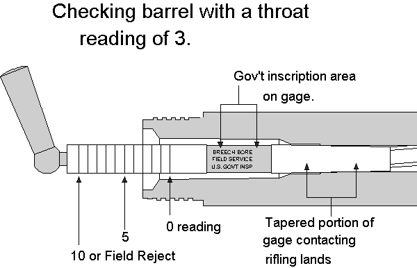

If working with 5.56mm NATO layout, you could try to dredge up a barrel erosion gauge and just measure instead of guestimating.
Pull the BCG, drop the tool through the receiver into the bore and if it's a go, then all if fine, if it's beyond the limit line on the tool, its basically shot out.

You could ask IG if he has a barrel erosion gage and check it for you.
A barrel erosion or throat gage is quick (it really doesn't tell you much).
A Stoney Point gage is better (you can gage the throat with the actual bullets you shoot instead of just a nominal gage diameter).

Description here: http://www.superiorbarrels.com/Throa...on%20Gages.htm
Quote:
The AR Master Caliber Gage is designed especially for the AR family of rifles. The Service Rifle teams gage their rifles often because they want to know exactly where they are as far as barrel life is concerned. They know at what point their rifles are about to lose top accuracy and when to replace their barrels. Military depots use erosion gauges to determine if the rifle needs to be rebarreled or just refinished.
The top long range and course shooters also keep close watch on their barrels using erosion gauges. Shooters, who load their own ammunition, with the proper use of this gage, can get more barrel life out of their ARs by knowing exactly where their throat is located. Shooting the AR without an erosion gage is like having a car without a working mileage meter and guessing when you should change your oil.
The military M16 gage has only one reading: REJECT. Other than that, it is anyone's guess as to exactly where you are in the life of your barrel. What is not widely known is that the REJECT point on the military gage is the point where the M16 shoots 7.2" groups or larger at 100 YARDS! Obviously, this is not acceptable to the match shooter. In addition, the M16 gage is designed to gage chrome lined bore ONLY.
Ideally, the AR Master Gage is first used on a new barrel and the reading recorded in your Round Life Data Book. Top shooters keep meticulous records on exactly the number of rounds they have fired through their barrels. If you are not keeping these records, REMEMBER THERE IS NO REJECTION RING ON THIS GAGE.
The AR Master Gage has been calibrated against a new Colt AR-15 Heavy barrel and cross referenced with a after market chrome lined barrel as well. A new barrel should gage at or about the fourth ring on the gage (See reading the Gage below). However, since there is a wide variation of barrel manufacturers out there you may see different readings on a new barrel. For this reason additional Witness Rings have been added in case you have a shorter than normal throat. One new barrel checked read only two rings at -0- rounds and may read as low as the first ring. You do not know until you check.
The AR Master Gage has several unique design characteristics. First off, there are enough rings to gage the useful life of any barrel, and you can trace the throat wear up until the point it fails.
There is a support shoulder on the gage. As the gage is placed in the chamber, the support shoulder will rest on the rear of the chamber and keep the gage at or near the middle of the upper receiver group. This assures you do not get a false reading by having it canted excessively.
You will note the gage is tapered. This allows it to find the location of the front of the throat so you will know how much more the bullet has to jump before it takes the rifling.
The AR Master Gage is precision made of stainless steel. With proper care, you will be able to pass this gage on to your children for their rifles. Always replace the protector cap when not in use to protect the point of the gage. Gauges are no better than their care.

How is this gage used? Ideally, your Master Caliber Throat Gage is GENTLY INSERTED into the bore. Care should be taken to keep the gage centered to give repeatable readings. It is precision polished to match the throat so it will not scratch or scar the barrel. Looking down from directly above the action watch as the gage is inserted. Count the rings as they disappear under the receiver bridge. To make things easier every fifth ring is extra wide. Therefore, if you pass the first heavy ring and then proceed two more you are at 7 rings or part thereof, i.e. 7 1/3 rings, 7 ½ rings etc.
If you have a new-barreled action, take time to record this reading in your notebook as -0- rounds. Then every 500 or 1000 rounds take additional readings and record how much further the gage follows the throat erosion down bore. On 30-caliber government barrels with government ammunition, the erosion progresses at approximately 0.100" per 1000 rounds. The rings are evenly spaced each .100" apart regardless of caliber.
If you are using this gage on a used barrel for the first time record the reading at the number of rounds you have fired. For instance, your reading is 8 rings at 835. At 1835 rounds, you take the reading again and determine how far the gage now goes into the barrel. If it has increased one ring in one thousand rounds, you pretty well know what it is going to read at 3835 rounds. To make it simpler, take an additional reading at an even point such as 500, 1000 rounds and you can pretty well guess what your barrel was when it was new.
