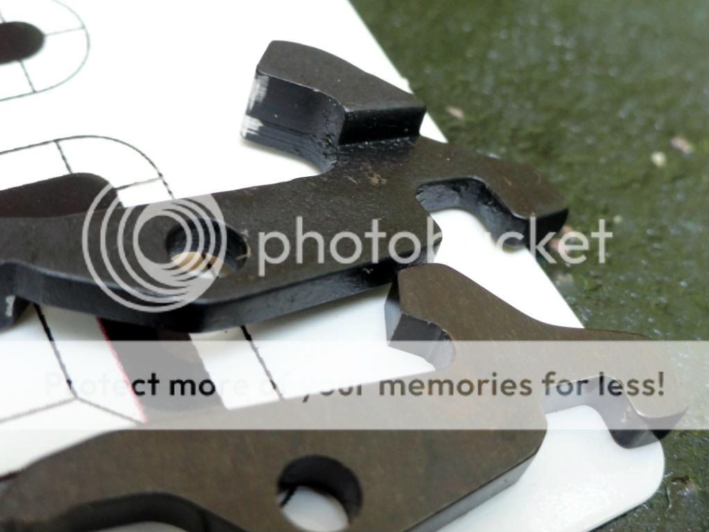

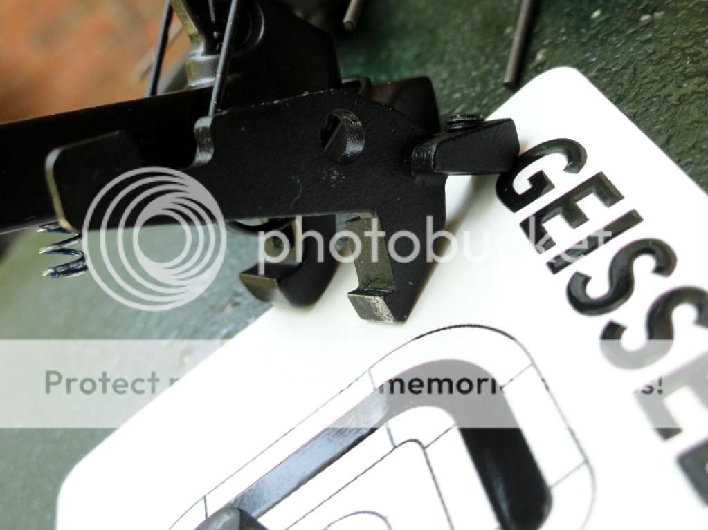

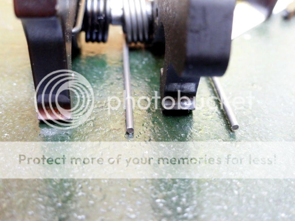

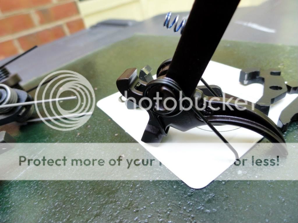

I have now extensively used both these triggers and as Ive said a number of times, the KAC 2stage trigger when done right(properly adjusted since it's design allows such) is a perfect feeling SSA, and now S2S trigger. After numerous rounds to the naked touch, these triggers absolutely feel the same down to the pull weight, stage length, and crispness of break.
One retails for $329.00...the other retails for $125.00
You be the judge...quality, construction, and overall design hopefully is captured in the below comparative pictorial.
http://i888.photobucket.com/albums/a...DSC00215-1.jpg
See better pics below...
eta..just for clarity I used a new S2S and a slightly used KAC for those pics, however I have owned and used multiple units of both triggers now and in the past.

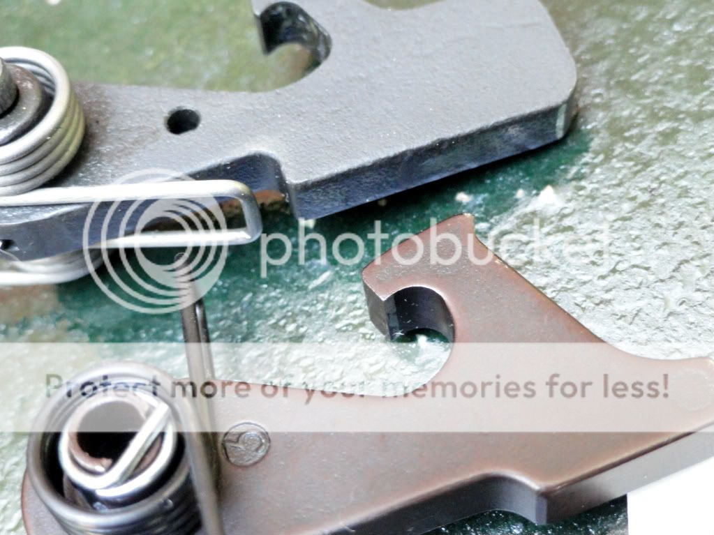

Looking at those pictures, I'd imagine that Geissele tumbles their parts between casting and final machining. The KAC parts have rougher surfaces where the surface roughness doesn't matter.
How's the surface finish on the sear? Both manufacturers use wire EDM, I believe.

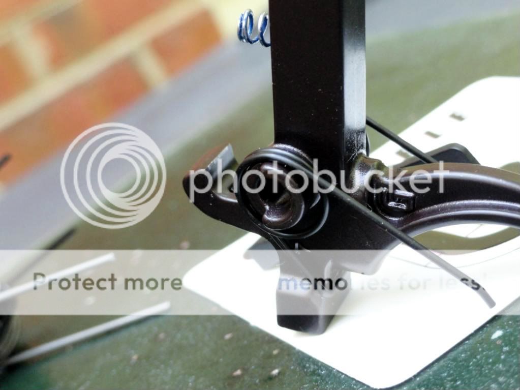

Contact surfaces...GA triggers never seize to totally amaze me!
