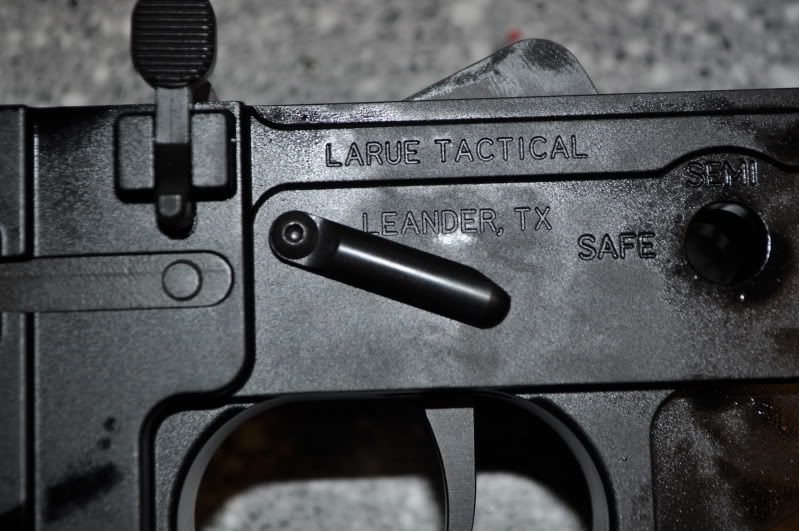

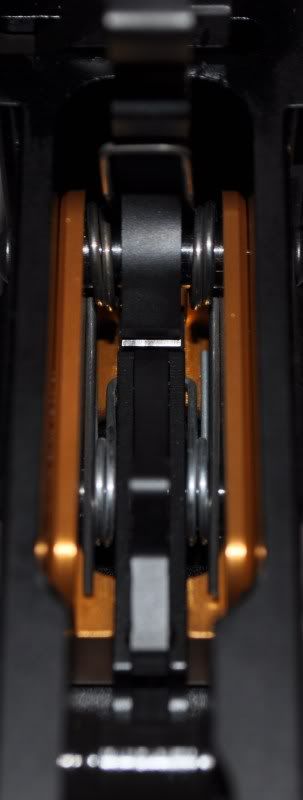

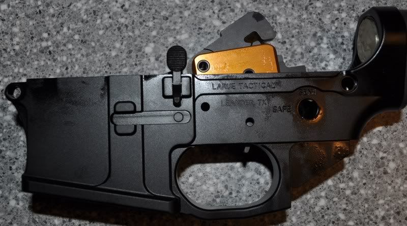

The Hogan Gold standard can be had for around 200 bucks and it comes with KNS anti rotation pins
http://i29.photobucket.com/albums/c2...DSC_0013-8.jpg
http://i29.photobucket.com/albums/c2...DSC_0011-8.jpg
http://i29.photobucket.com/albums/c2...DSC_0017-8.jpg
