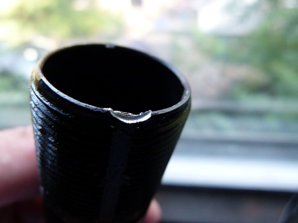

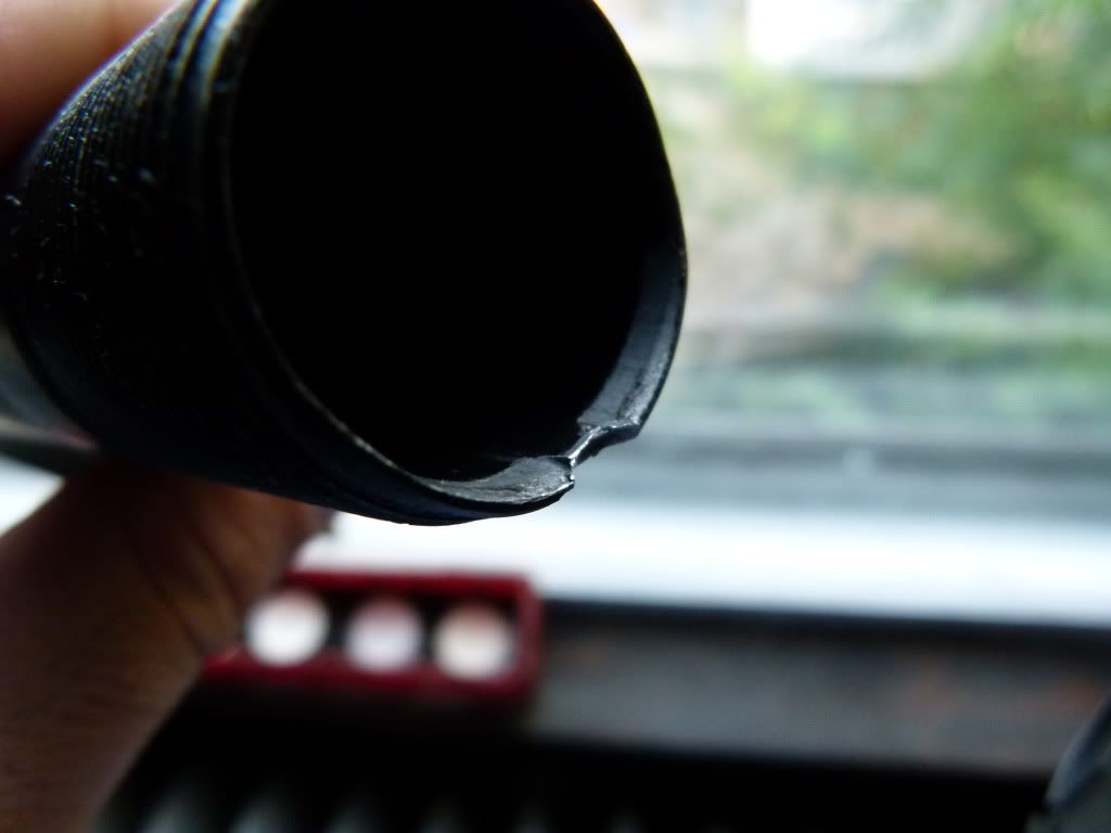

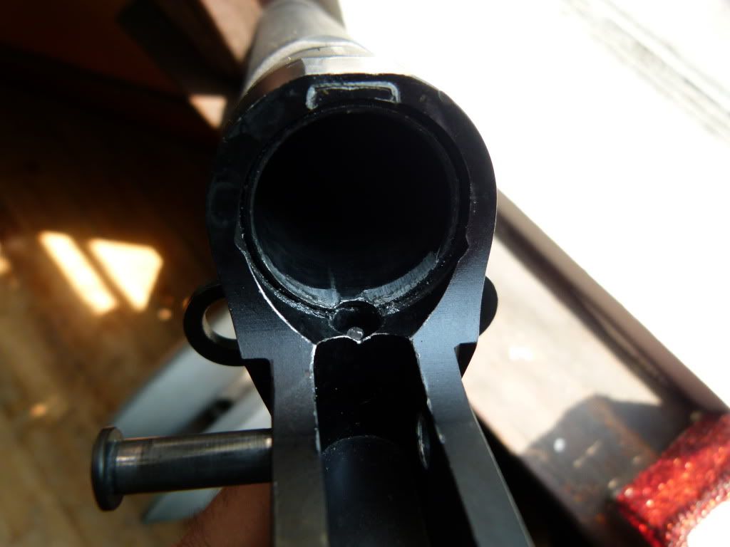

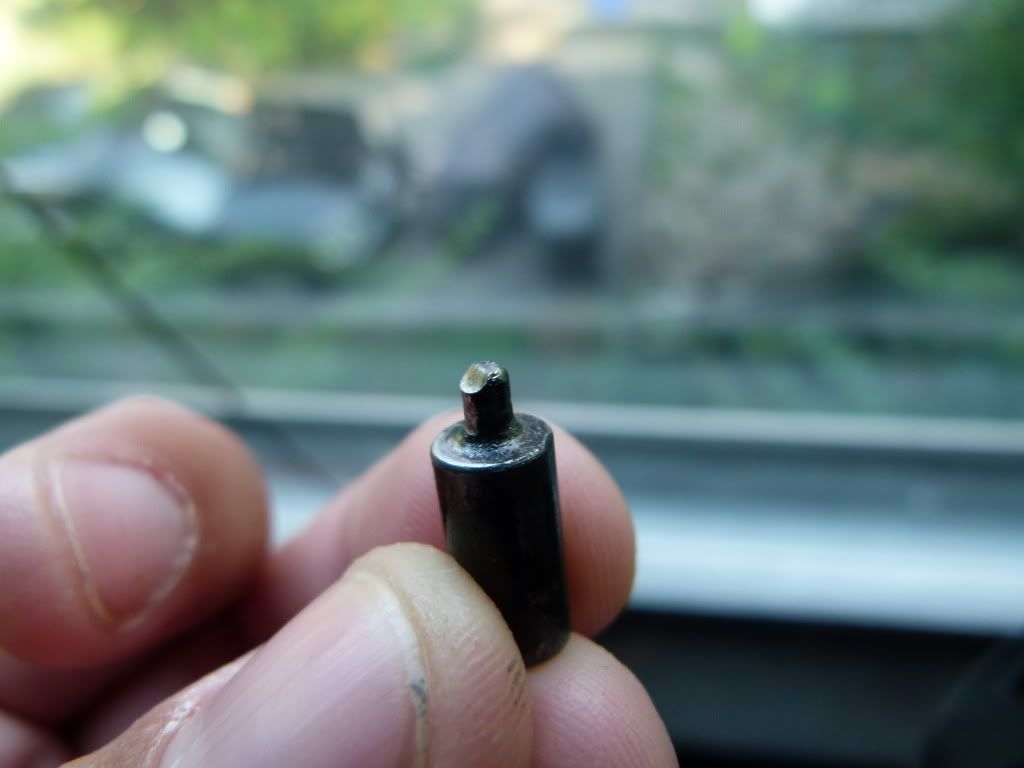

Ok gents this is a confirmation that carrier tilt does in fact exist . This is my buffer tube with over 10k worth of rounds through it with a piston conversion (LWRC with the enhanced BCG) keep in mind I run my guns hard while preforming the required maintenance. There are solutions from companies like PWS that offer a long-stroke piston upper and a tube for existing uppers. This could cause a world of fail in the right instances. The wear was significant enough to “eject” the whole buffer retaining detent and spring. Rob-s jinxed my shit for realz.
