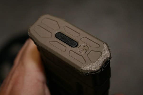

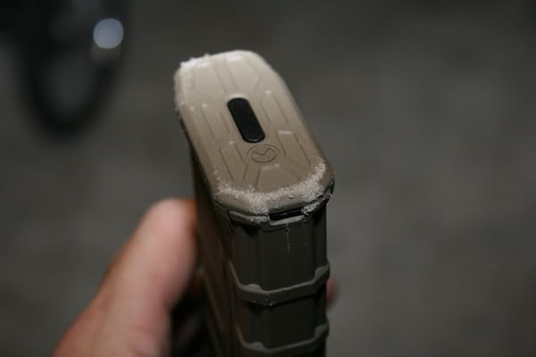

Here is a picture of PMAG after doing 100 drops from the magwell of my rifle onto concrete. Magazine was unloaded. Other than some scuffs, no damage to the magazine. Functions perfectly.

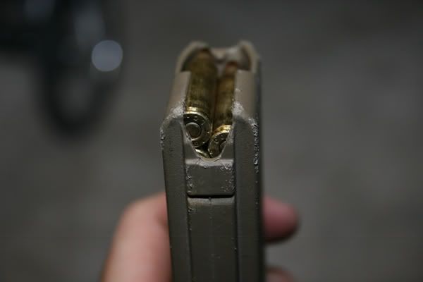

Here is another one, after 55 drops on concrete, loaded with 20 rounds to simulate dropping a partially loaded mag. This would be more severe than most would subject their magazine to, since most would retain this mag. Also, the was a straight drop down onto the concrete which really stresses any magazine. In most instances, you will be moving and the blow would be glancing. Still, the PMAG functions fine.

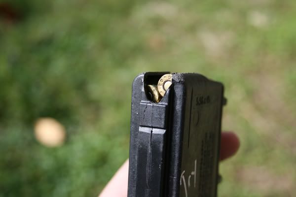

This is the same magazine, but showing the feedlips. Normally, the magazine would bounce when it hit the floor and about half the time lose a round or two. You can see a small crack starting to form on the back spine of the magazine. This did not effect function or retention of a full 30rds

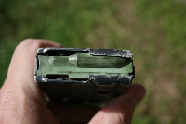

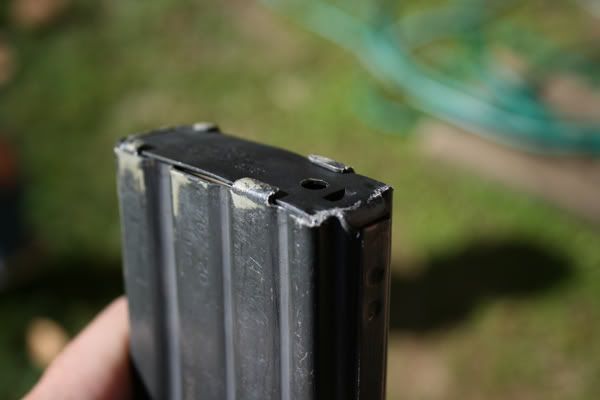

Now, for the USGI. It faired about as well as I thought it would. For the empty mag on concrete test, after 10 drops it had shifted so much as to change the feedlip geometry. I did not try to fire this magazine to test for function, but you can clearly see the damage in the picture. This is why the original MAGPUL's or the ranger floor plates help out in multiple ways.

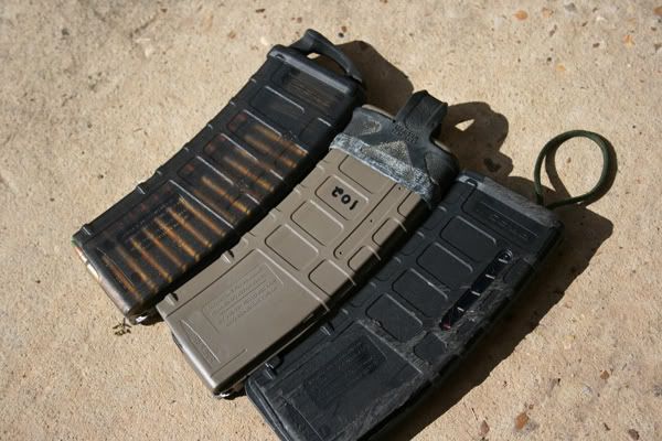

Here is a picture of the mags three methods of retention. From right to left, 550 cord through a 1/4 hole drilled in the floor plate. Normal Magpul slipped over body and pre-production Ranger floor plate. And no, the translucent magazine is not available yet.

Now for the drop test on the feedlips. This is probably the toughest test of a magazine. Here is where the PMAG is most vulnerable. When empty, the mag can be thrown against the ground, stomped on, dropped, run over and anything else you can think of and have seen on youtube.

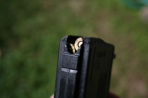

The problem comes when you add the weight of the column of loaded rounds and drop the mag straight on its feedlips. I'll try to explain why this happens. The magzine is open at the feed lips and therefore that is the weakest point. When dropped feed lips down, the mag contacts the concrete floor/street and the column of rounds tries to keep moving. The right top round is already in contact with the ground and the only open area is immediately to its side. This would be the 29th round. All the weight tries to push next to the 30th round. This causes the lips to wedge apart. The PMAGs I tested survived 7 drops before developing cracks down the spine. They were black windowed and non-windowed. If you continue to drop them after they crack, the crack will just grow down and out to the side of the 29th round.
Now, the good news. The mags that eventually split, still could retain the majority of the rounds. One or two would spit out. The benifit of the PMAG is that when it does crack, it doesn't break completely off. The magazines that where dropped after cracking, where able to be loaded into the weapon with no additional effort from a normal magazine. Once inside the weapon, the magzine functioned normally. So, even if you somehow get a split magazine, you can still use it. Now, the USGI didn't even compare. After four drops it could not even be inserted into the mag well, let alone feed anymore because the feed lips where totally jacked up.
