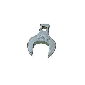

All - I've got to quote myself here. Got my NSR rail in a few days ago - this Sunex Crowfoot is TOO WIDE to fit the NSR barrel nut center flats - it's a no-go. 1 1/16" is right but it needs to be narrower. Hopefully I can save some folks some hassle here. Problem is tryingto find single crowfeet is a PITA. They all come in collections, of which I really have no need for. I'll update if I find something that works without requiring a set to be purchased.
Thanks, yeah - just went ahead and ordered it from Snap On as well. Ugh. Add it to the Snap-On pile.
Only problem is I also "found" about $200 of other Snap-On stuff I ordered with it! :p
I'm a sucker for Snap-On. The actual foot width is 3/8" on the Snap-On, which is perfect.
