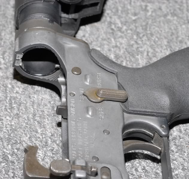

To illustrate markm's point...
Here is an example of why you shouldn't put a suppressed HK416 upper on a rare M16A2 lower (100% Colt parts - H buffer). The bolt group was coming to its usual and sudden stop at the back of the receiver extension with enough force (that of Thor's hammer) to compress the pad on the buffer to the point that the gas key was able to come into contact with the lower receiver. You couldn't fit a heavy enough buffer into the receiver extension to prevent the damage. While exaggerated, this is a perfect example of why gas piston systems are not the cats meow...
On the plus side, he now has a staked receiver extension.
http://i917.photobucket.com/albums/a...ent/Raw007.jpg
