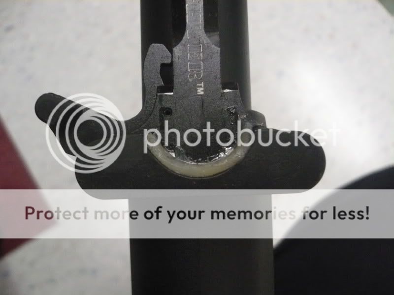

    You can use RTV silicon to mod your charging handle into a Gas Buster like handle, or drill small ports into either side of the CH body.
    And if you take a standard barrel (DD 16.1'' CAR Gas = .058'' port) and have it cut (10.3-11.5), and just not have the port worked on, you should have (close to if not exact) a gun specifically tuned(ported) for a suppressor. No gas in face, no extra recoil, no extra decibels, etc.

    I have done the silicone but I would love to see what you mean about the ports.
