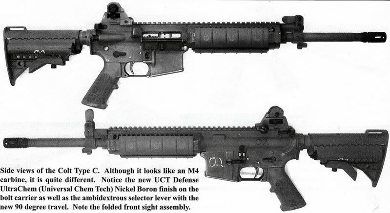

    This is the earliest piston AR- 1969 Colt 703, tested against the M16A1 and was found to not offer any tangible improvement.
    Then there was the Type-C In the SCAR trials(2003) The FN entry beat it but it did complete testing.
    Then there was the Colt M5(2006).
    Now we have the 6940P, it is currently in the IC competition.

    Is their any difference between the Colt M5 & APC/ LE6940P? They look very similar, also the Colt 703 looks like a great design, basically a copy of the AK47's piston system... too bad they decided to go DI you know that saying about DI AR's "don't shit where you eat", hot gasses, unburnt powder & carbon fouling going in to the receivers trigger ect. is the AR's bigest design fault IMO.
    Main difference is the barrel the 2006 rifle had the M4 barrel the new 6940p(M4 Enhanced IC) has the A1 barrel. Also from what i can tell the 6940P op rod is slightly larger in diameter. The Type-C was a well designed winning piston system so they refined it into what became the LE1020, and now it is called the 6940P.
    Wanna see something interesting??
    This is the original M5 design then they chose to go monolithic, this also predates the HK416
    Looks familiar huh?
    Link? Proof?

    Quote Originally Posted by GrumpyM4 View Post
    Link? Proof?
    This is the best I can do a prototype picture. The earliest pics are from 2003.
    Im honestly not sure when the M5 became the LE1020, i have seen the M5 demo'd at the same time as the LE1020 and then in later years gone and the LE1020 is now called the M5. It gets rsther confusing, but the M5 came first.
    I have even seen the M5 with a delta ring assembly which i always assumed came first followed by the one linked but who knows.
    So did the delta ring M5 or the non delta ring M5 come first?....
