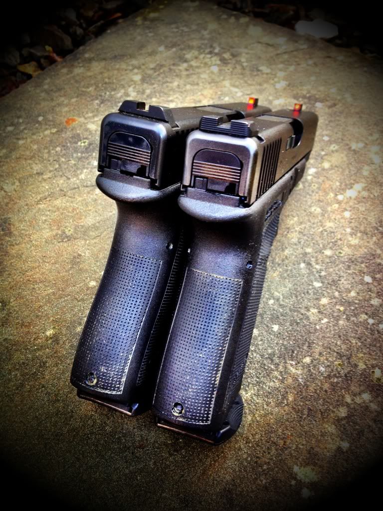

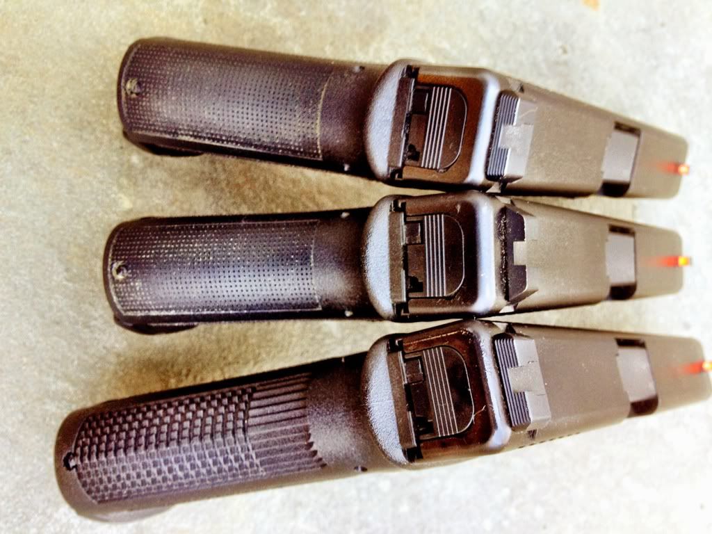

    All of my hard use SD/HD guns wear plain black rears with a front post that has a high vis ring surrounding a trit insert. The orange circle really helps my first shots out of the holster 1.09- 1.2 at 3-7 yds and for me that is critical. I have found I am .50+ slower with a plain black front.
    I prefer my rears to be serrated and to sit flush with the rear of the slide. They must also have enough of a ledge for one handed manipulations and charging the weapon.
    I will leave the brand out but here are a couple pics of my preferred sights on my Glocks.
