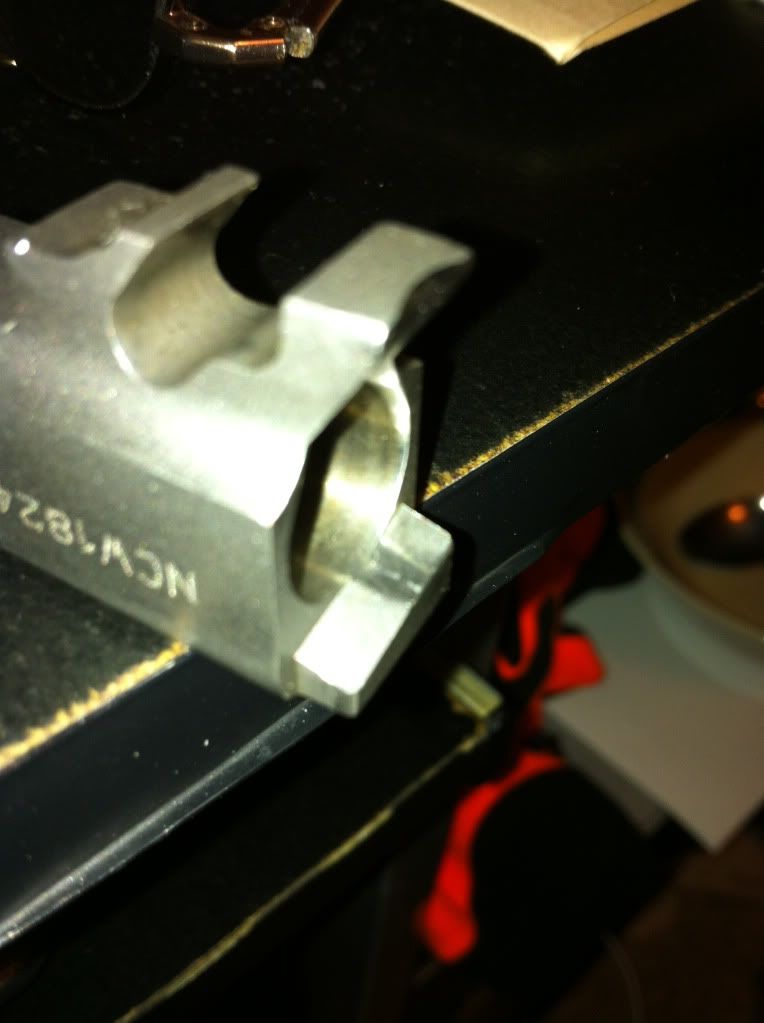

    I'm having issues with my father's Taurus PT145 pistol, in the area of not feeding properly. It will fire two, sometimes three consecutive shots (all FMJ 230gr), and the next round will not chamber. It does this with both factory magazines, but my first intuition jumped to the magazine catch. The release spring feels tight, but the magazine has a little movement to it when loaded into the gun.

    I am not familiar with this gun, but my guess is that it has the same issues that a 1911 can have. So remove the slide from the frame and if the gun has a feed ramp, check to see if there are any marks BELOW the ramp. If no feed ramp, then look to see if the top of the hood (inside the barrel) is rough.
    To quickly see if it feed ramp issue, shoot some hollow points in the gun. If it will shoot these then I know what your issue is.

    Well, to address the accuracy, I was holding off-hand groups of 3.5" with this gun, which is more than comparable to my 1911 shooting skills. To be a 3" barrel, I found it very satisfying to shoot at 21'... if only it would feed!
    I'll try to get some hollow-points through it tomorrow afternoon, if I have time to visit the shop. Here is a picture of the barrel, as you asked for, Grant. This is the only abnormal wear I could find. The feed lip on the barrel looks smooth, no knicks or scrapes...
    Thanks for all the help. I plan on taking it to the range tomorrow and try the other magazine I have for it, and shoot some hollow points as well.
