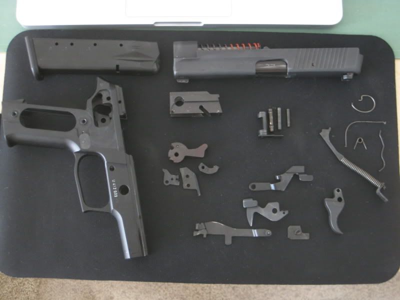

    The Classic "P" series SIGs are relatively simple and straightforward to detail strip. Unless you're using power tools, there's really no way that I can conceive of that you might damage the frame.
    Dropping an SRT in does not require a full detail strip, but I did one anyway using youtube as my guide:
    Too easy.
    I loved the SRT trigger, so I dropped one into my P220 next. After that I detail stripped one of my P6's just to do a deep clean and get a little rattle can action going on some of the parts.

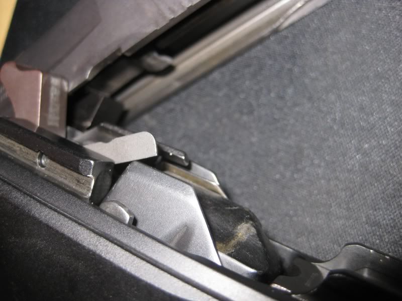

    The only part you could possibly mess up on and install upside down is this one:
    The gun will function check OK with no mag, but you will quickly realize and just flip the new arm.
    I say go for it. It will enhance your knowledge of the platform and if you get stuck you can always ask someone for help.
