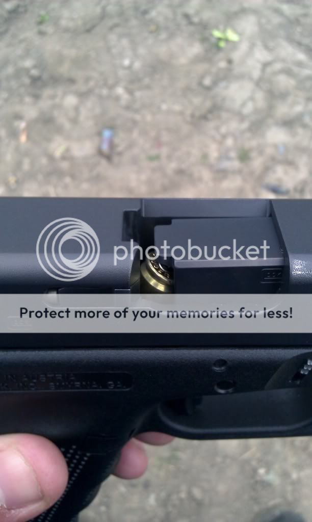

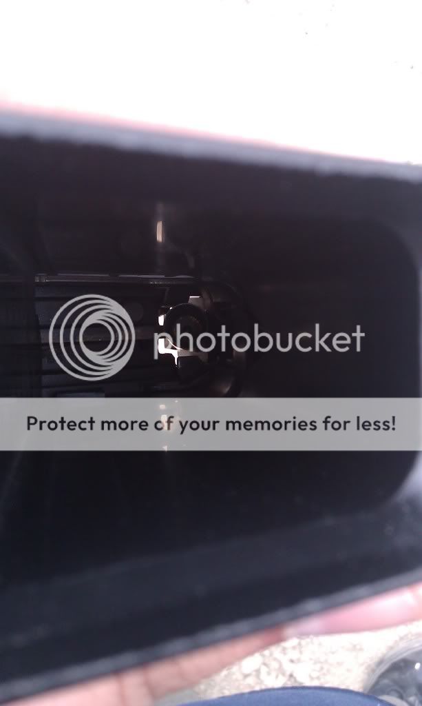

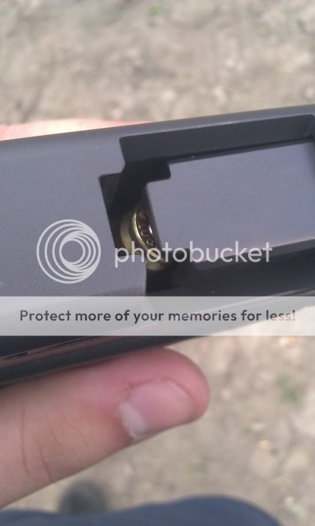

    I recently bought a New Gen4 17 and outta about 300 rounds only had this one weird malfunction. I was shooting Saturday and towards the end of my Range session I had Loaded one round into chamber by hand without a Magazine in the gun when i shot it the Spent casing flipped end down the Slide closed on the primer end of the Case. I was shooting Federal Range and Target 115GR FMJ 9mm RT9115. I never seen this before so I tried to see if it would do it again a few times but ejected fine. here is a few pictures of the malfucntion.

    Now, to the OP, yes, that is a WEIRD malfunction but its not considering how widespread the issues are with recent production Glocks.
    Your extractor lost its grip on the case rim at some point during the extraction cycle and the case essentially tumbled in your ejection port and was pinned by the slide as the gun returned to battery.
    The follower in the mag or the next round in the magazine acts as a buffer to the spent casing so generally speaking you would either stove pipe or the round would be kicked free by your ejector.
    SOME glocks will hold the case rim tightly against the breechface without a magazine in the gun and WILL eject the round positively. Others, will not and the spent casing will tumble out of the magazine well.

    Are the first three pictures "the" malfunction of which you are describing, or a recreation of the malfunction?
