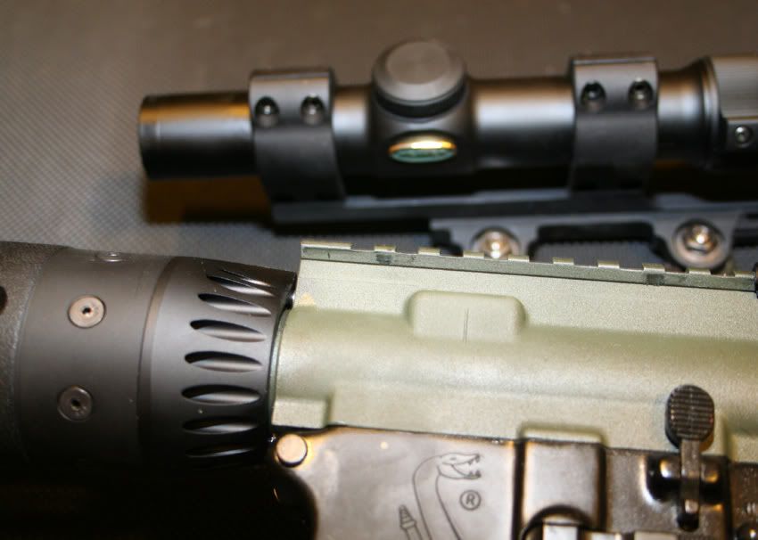

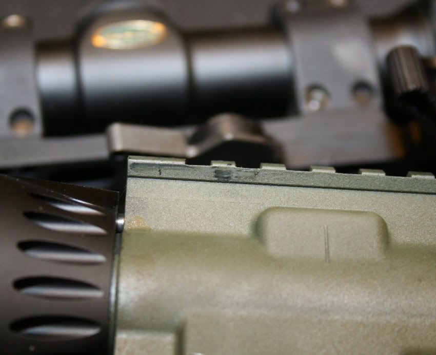

    Here's some more pics.
    This is my wifes (9x19) 3gun rifle. The upper is finished in OD green GunKote, the mount is a LaRue SPR 1.5 1" with a Weaver 1-3x scope.
    The mount rubbed off the green finish but not the anodizing.

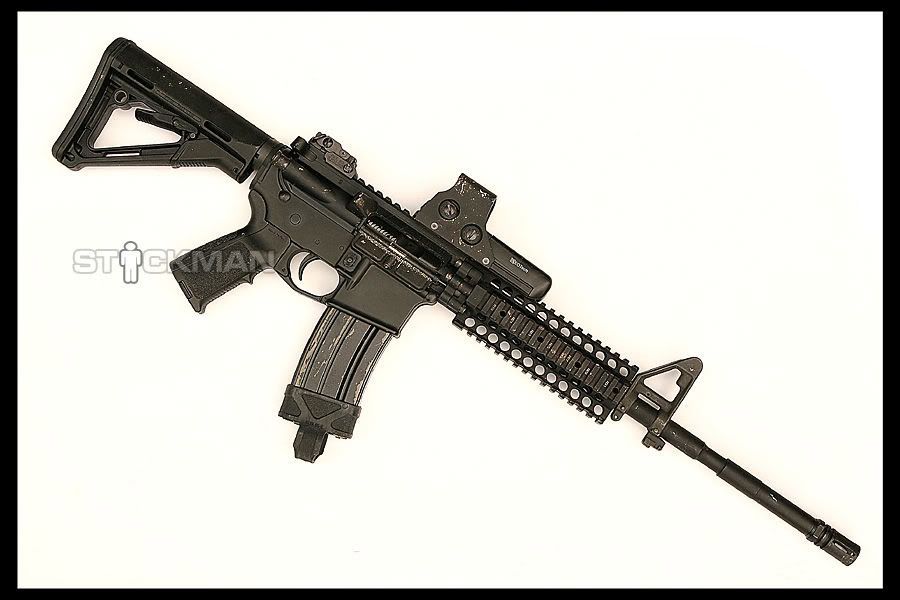

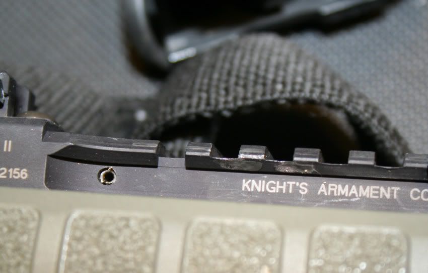

    This is my LMT 10" SBR with KAC RASII rail I use an Aimpoint T1 on a LaRue mount out on top of the rail.

    Grant, I beg to differ with you on why our LT mounts work. They repeat and retain zero because LT levers exert the same torque upon the mount-to-rail each and every time they are mounted. No magic, it's that simple.
    Additionally, in regards to the "smudges", we once measured the "smudge" depths during multiple on/off testing, and those marks you see in the pics are ~0.0006" top to bottom. Please note that 0.0010" is a thousandth of an inch. A hair is ~0.0030" in diameter.

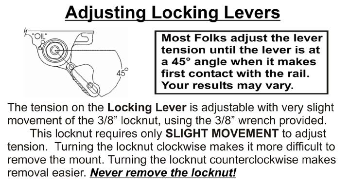

    As to properly adjusting LT mounts, here's the instructions we send out ... I like the angle to be 45 degrees, Bennie Cooley insists that the angle be 60 degrees, so somewhere between 45 and 60, YMMV.
    P.S. The note regarding the locknuts is there because it has been my lifelong experience that locknuts don't fair well with reuse. Don't take them off. The device has enough travel designed-in to accomodate any picatinny size one might encounter. Additionally, there is nothing to service in there...and you run the risk of losing stuff and having to call us, etc. 1 turn equals .032", 1/4 turn equals .008", 1/8 turn equals .004". Ultra-fine adjustment made easy.
