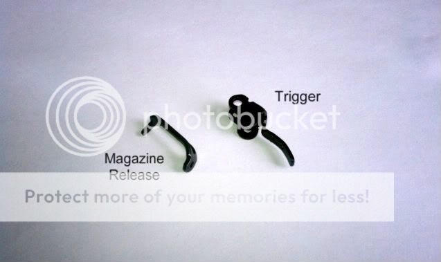

    I've heard on several occasions that, while the M9/M9A1/M92A1 series now contain a number of polymer (or polymer-coated metal) parts, they don't use any MIM components. If true, this would appear to be the exception to the trend in modern handgun manufacturing.
    Is this based on the performance/cost of polymer vs MIM, a carryover from their military contract requirements, or some other factor?

    This is what the mag release and trigger look like without their polymer coating...
