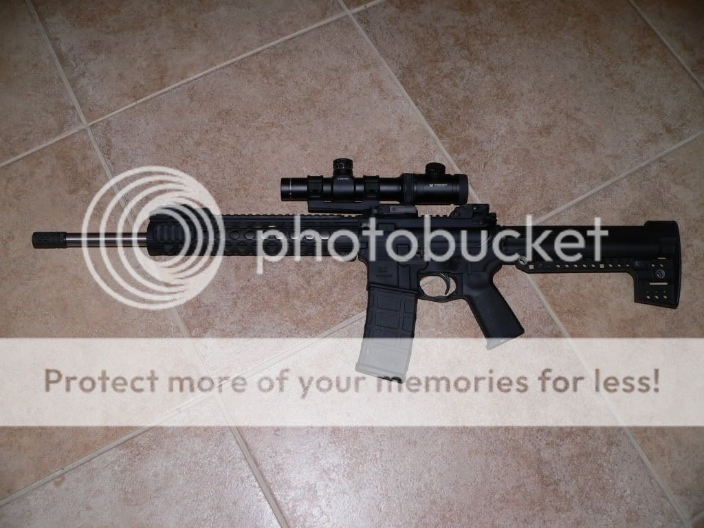

    Vortex Viper PST in a Bobro Extended Mount on my 3 Gun rifle. Have found this scope to to be excellent for my use - also bang for buck is outstanding.
    Glass is incredibly clear with no fisheye effect. When dialed to 1x power, the eyebox on this scope is huge - very unpicky as to where you have your head, I notice barely any difference between using this and a red dot. The reticle is very easy to pick up for close in speed work; not that it bothers me as I use it without the illumination unless it is a very dull day, but the one thing that could be improved is the illum could do with being a little brighter.
    Shooting at range, again the reticle really shines - the stadia lines work very well when working out your holds. I shoot out to 400 on occasion with this, and at 8" plates at 200-250 regularly. Given the turrets are also adjustable, you have the option of also using them to dial. Personally for me on a 3 gun rifle, I'd sooner use the holds and to be honest, the exposed adjustable turrets are a bit of a liability when dumping your rifle in barrels, pulling it out of your bag etc - one time the windage turret shifted 2 MOA when I was pulling it out of my bag just going into a long range stage, which messed me up. Lesson learned - I have now gotten the turrets taped up so they can't move. If it had been available when I bought the PST, I'd much sooner have gone with the HS, which is the same scope but with capped turrets making it a better choice for 3 gun (and practical/tactical) shootings knocks and bumps (and its also cheaper).
    Comparison - I can compare this to a Trijicon TR24 I had. For me, the PSTs reticle works better....especially at range. I also feel the glass on the PST is *slightly* superior to the Trijicon - on that at 1x, I could detect slight fisheye at the edges where on the PST there is none as far as I can see.
    In summary, a very nice robust and clear scope for not a lot a lot of money - although for practical type shooters, now that it is available, I'd advocate the one with the capped turrets (as I understand it, I think they are now doing away with the HS name, and it is now called a PST (capped), which is probably more fitting and avoids confusion.

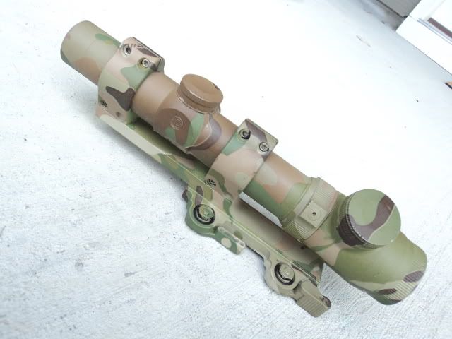

    I've been running an Elcan SpecterDR for a couple years now. I use it for classes, range and training, so no combat use. It's a little bulky/heavy (though not too much compared to, say, and ACOG with mounted RDS).
    It is a 1-4x (pretty damn close to true 1x), and I primarily use it in that role--it compares favorably to the Aimpoints I've used in FOV, parallax and eye relief. My only complaint there really is battery life--if they could incorporate Aimpoint's tech they would be supreme.
    The really nice feature is the "push-button" 4x, which comes in handy for quick target PID or snap longer-range shots. It's a lot handier than the Short Dot or similar twist-magnification scopes, both going to 4x and coming back to 1x.
    The mount is the typical Elcan monster, and the ARMS levers leave something to be desired, but I don't remove it from the weapon often, and I've never had to re-zero it when I do. Bottom line, if they got the battery life up and maybe offered a different mount, it would be a no-brainer for me; as it is, it's still good enough for everything I want it to do. (I should add that I got a pretty sweet deal on it, so I didn't pay close to retail...)
