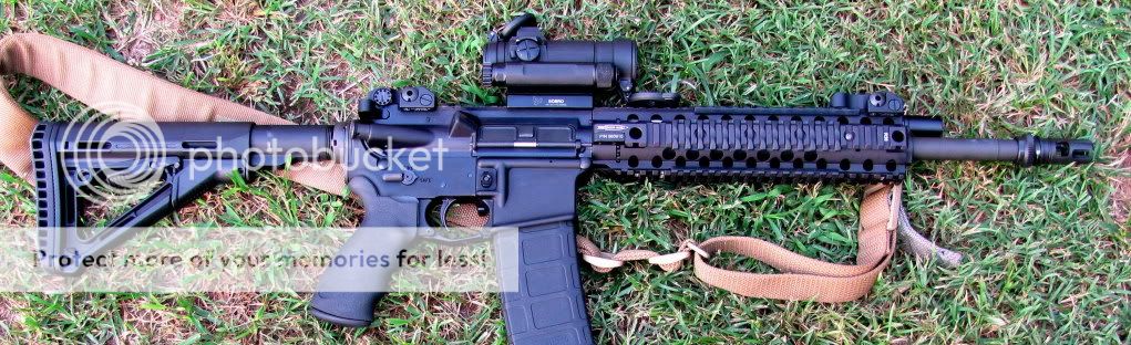

    This is my setup and it works well for me. It is not what most would consider a serious high speed competition carbine. It is my training/competition carbine and what I will grab in a SD/HD situation. Works well for me.
    Daniel Defense 14.5" midlength
    AAC 51T Brakeout Comp
    10" Centurion Rail
    BCM FA BCG
    BCM Mod 4 Charging Handle
    LMT Lower with Std Milspec Receiver Extension, H-Buffer and Springco Blue Spring.
    Currently has a ACT Trigger installed. Not in pic
    Aimpoint M4s in a Bobro mount
    No longer have the BAD Lever in the pic. I did find that it increased my reload speed. However, it would not work on one of my lowers......so, I'll have them on none.
    I can't say that I recognize or notice recoil in a 5.56 any longer as long as the recoil impulse is into a good shoulder purchase. What I do notice is the muzzle climb. Especially on multiple targets.
    For comparison, I own a BCM 14.5" midlength MOE with the A2X bird cage, and the difference between these two carbines is like night and day as far as muzzle climb, and hence speed on multiples goes. I attribute it mostly to the AAC brake and the overall weight of the rifle.
    The AAC brake/comp does a terrific job.....but it is loud as hell.
