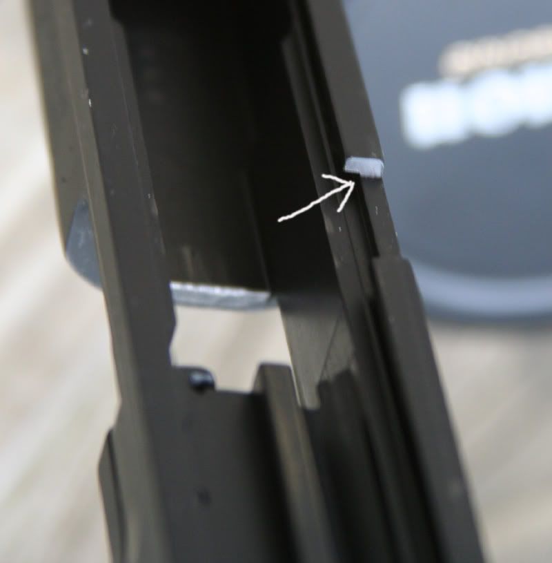

    Here's a pic of my wifes M&P9. I put on arrow on the 90 degree cut of the slide track/rail. I believe this 90 degree cut to be a weak spot. I also wonder if say after 10-15K rounds maybe the front locking block (which has the front integral frame rails) should be replaced as a PM item?

    1,537
    What slide is in that top pic?

    That's the one Dave Pennington posted in the thread opener.
