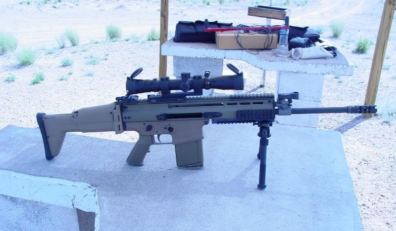

    I'll second the NF 2.5-10 for distance and general shooting. I robbed a 2.5-10x32 off my 18" A/R for initial use on a SCAR 17. Zeroed it Saturday and tweaked my Android "Shooter" ballistics; and shot a CQBish match Sunday. It may just stay on the 17.
    I ran it today to 700M with a 1st round cold-bore hit on a 12" gong - although that's stretching things for the surplus 7.62 ammo I'm using. (The 2nd shot was just wide and the third hit the head of the club's 8" mini IPSC gong I was wired to - cutting my fancy bailing wire hanger).
    10x is handy if you want a good read on your ammo/rifle/shooter capabilities. With your budget, it could be a T&E setup. From today:
    At 200M: 5 @ 2.5" for 1.1 MOA.
    At 385M, 5 ran 7 1/4":

    Quote Originally Posted by shootist~ View Post
    Outstanding !
    I was hoping you were listening to my experience/intel w/ my Elcan Specter DR as I read your request to elaborate last week.
    Nice shooting & I'm getting pretty much the same results. You gotta love that kind of groups @ 200M !
    Seems to really complement the SCAR 17S for pragmatic applications imo.
    As always the Leupy, Z6 & S&B are great options as well.
    I do like the 10x ability of the NF too.
    YMMV....

    Quote Originally Posted by HOPLOETHOS View Post
    Outstanding !
    Yes I did. Related to those comments - after zeroing the 17S I ran some groups on steel with the NF at 2.5x (at 100 & 200) and at 6x at 200, 300 & 385 meters - if there is any shift in POA/POI, it's not enough for me to notice.
    The 50/200 zero actually works for this rifle/ammo combination, btw. From prone/bipod at 50, it's about perfect at a blond-one high.
