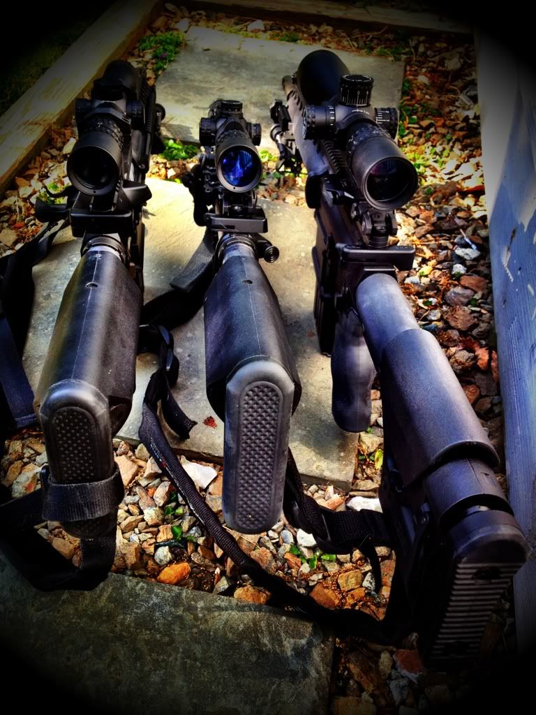

    I have been very happy with the Bobro 30mm E with a NF 3.5-15X50 MLR Zero Stop. It is a very well made mount and I really like the locking system on it. It holds zero well with no shift when remounting it. I have run it on a variety of guns from a OBR, MWS and 18" Stealth all with great results. When the new MK6 hit I will be adding a couple more of them. I have always been a Larue guy but IMHO Bobro has done outstanding job on this mount.

    d90king, nice collection!
    I agree, Bobro is 100% top shelf. The only point (if it even matters) that I think LaRue holds an edge is the fact that their levers can be opened with a single hand, where the Bobro requires one finger to depress the unlocking tab and another to operate the lever (I could never master doing so with one hand).
