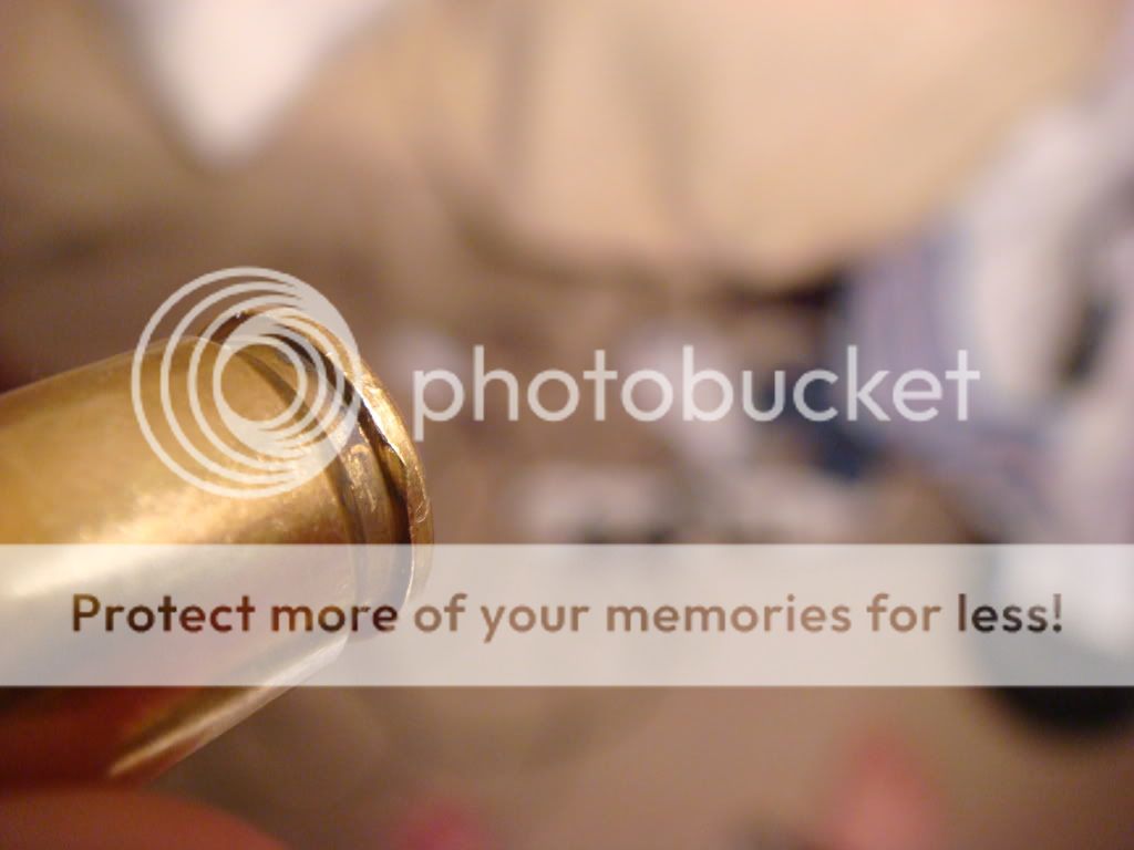

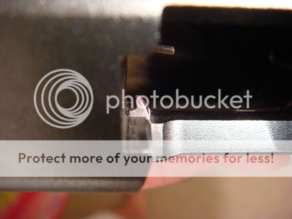

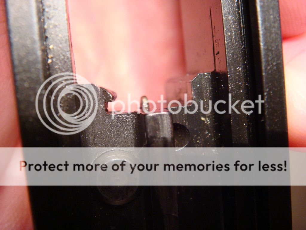

    I picked up a 08 glock 19 with NS and 3 mags and less than 1k rounds fired for $400 cash, which I thought was a steal. I got a chance to shoot it briefly yesterday and everything seemed fine except I got 2-3 spent casings to the head in about 75 rounds before dinner.

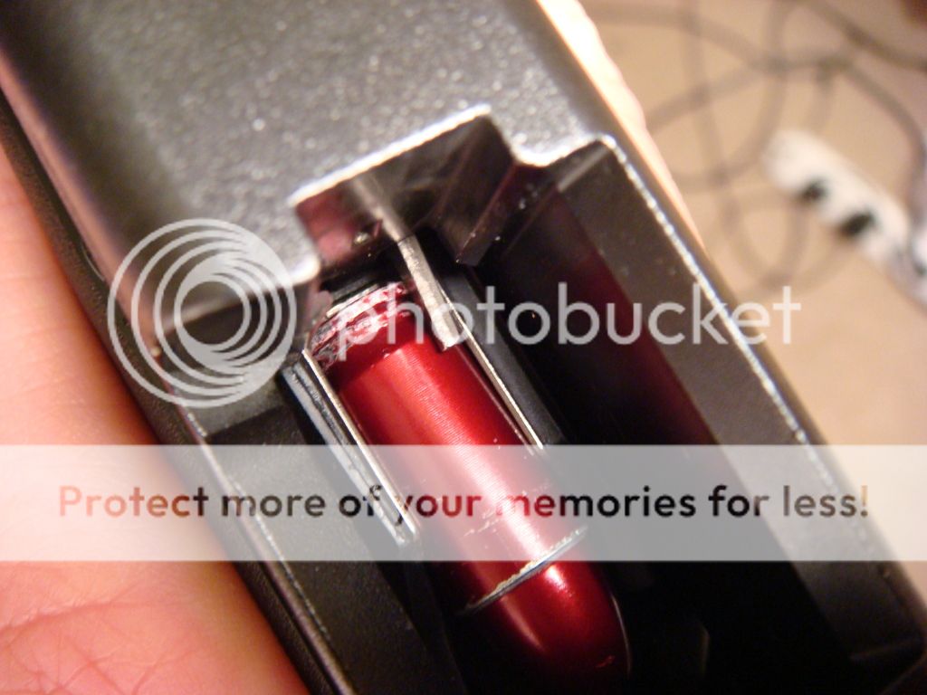

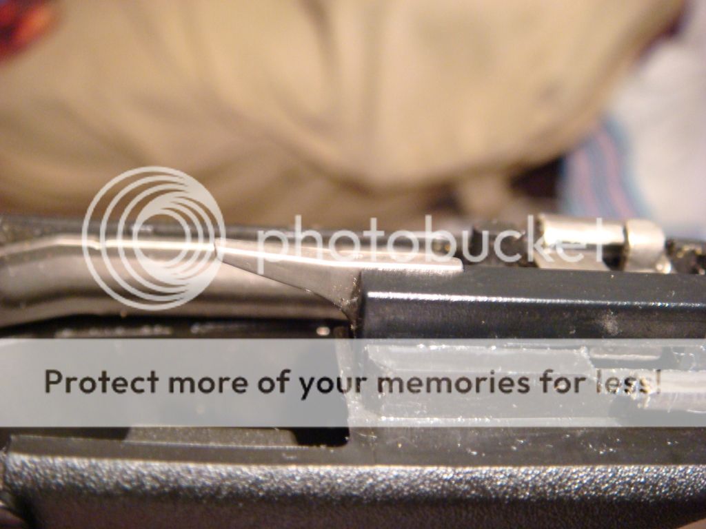

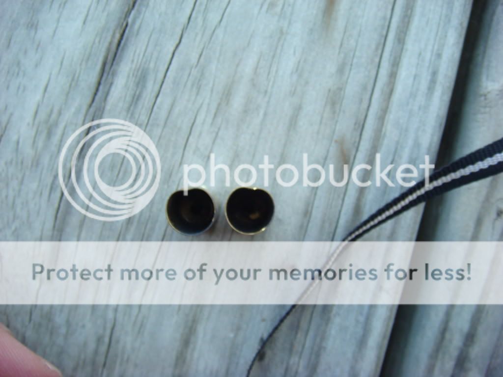

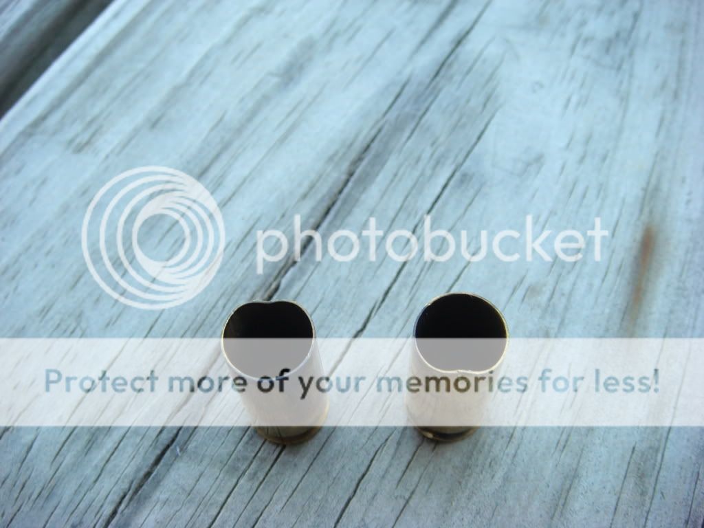

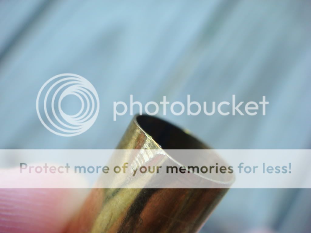

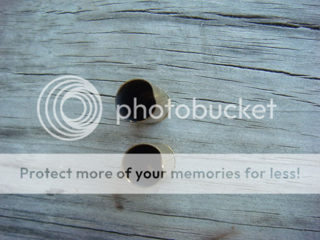

    I picked up some of the shells and noticed something kind of alarming on about 9/10 shells. I'm not sure what's causing it, the only thing I know is that it is happening on the right side of the gun and I can't replicate it without firing it. I can pull the slide back hard enough to eject a snap cap and will get a slight dent in the same spot that the damage to the casings are happening at.

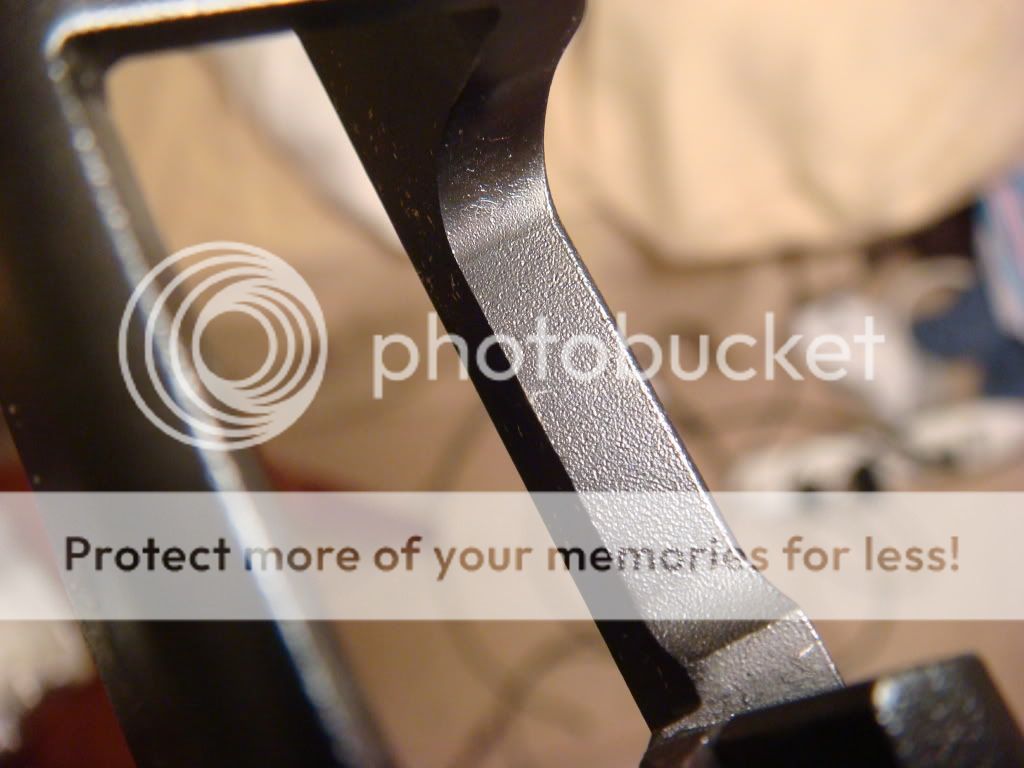

    My only guess is that it is hitting the trigger bar ear on the way out, perhaps caused by a weak RSA that is causing the case to come out faster than normal? Anyhow, on to the pics.

    tdoom15:
    These marks usually indicate the shell is running into the lower edge of the ejection port instead of being thrown clear through the port.
    Quote Originally Posted by tdoom15 View Post

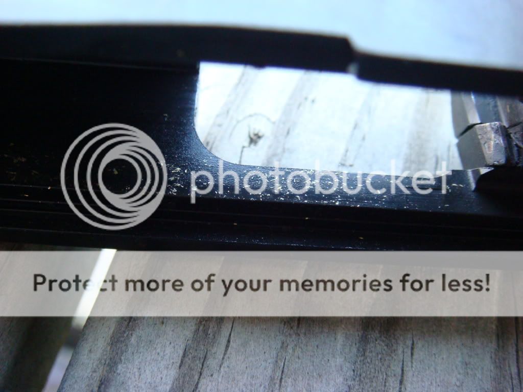

    If you inspect the inside face of the slide at the bottom of the ejection port, you might find brass smudges where the brass is impacting.
    Also check the rims of the shells in the photos. Likely there are marks, inside the rim and aligned with the dent shown in your photo, where the brass has been wrenched out from under the extractor.

    Thought casings might be hitting the safety detent on trigger bar (what looks like brass polishing) but testing the idea shows me that is not likely the case.

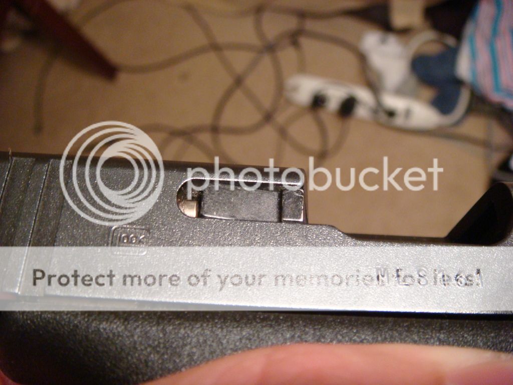

    There are a a couple threads around here discussing this problem seen with the ejection port. The ejection port can cause issues with clean ejection of spent casings.
    Firing a round without a mag, most glocks have trouble ejecting cleanly which shows how low the casing actually is when being pulled out by the ejector to the point where it needs support from the magazine to eject cleanly.
    This is addressed by certain aftermarket slides or custom ramping of the ejection port, that have a much lower/more angled ejection port opening.
    Pretty sure if Grant sees this he will be able to speak in more detail.

    Quote Originally Posted by Wildcat View Post
    tdoom15:
    Also check the rims of the shells in the photos. Likely there are marks, aligned with the mark, inside the rim where the brass has been wrenched out from under the extractor.
    I do see where the rim of the case has definitely been wrenched out

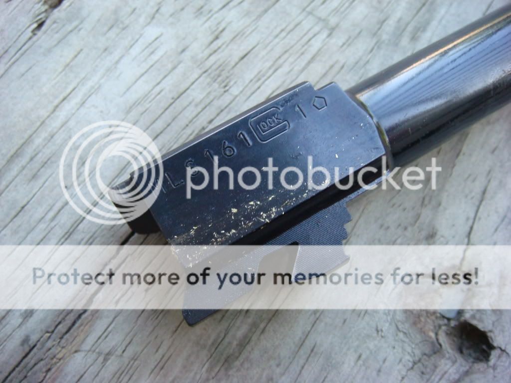

    The casing contacting the slide was my first thought, but it seems way too clean for having that much brass hit it, unless it is the exact same spot every time...which you can see in the pics below do show a very little bit of a marked spot that could be it?
    That looks like the spot. It would be roughly 17-19mm forward of the breech.
    Do you have a different extractor you could try?

    I was using speer 124 gr lawman, 75 rounds out of the 2008 dated glock 19 and 75 out of a PPQ. The PPQ had zero issues. I've seen scratched cases before, but never as bad as the ones I posted above. I may go put a couple hundred more rounds through it tonight to see if this is going to be an issue, unless someone can tell me otherwise? I forgot to mention there was one stove pipe, but it was my gf shooting it so I'm not ready to attribute it to the gun.
    I understand that glocks have always had this issue to an extent, but is this bad enough that you guys would recommend doing something about it? This is something that will be used for occassional CC, and HD.

    OG, don't you feel better now that you let that out?

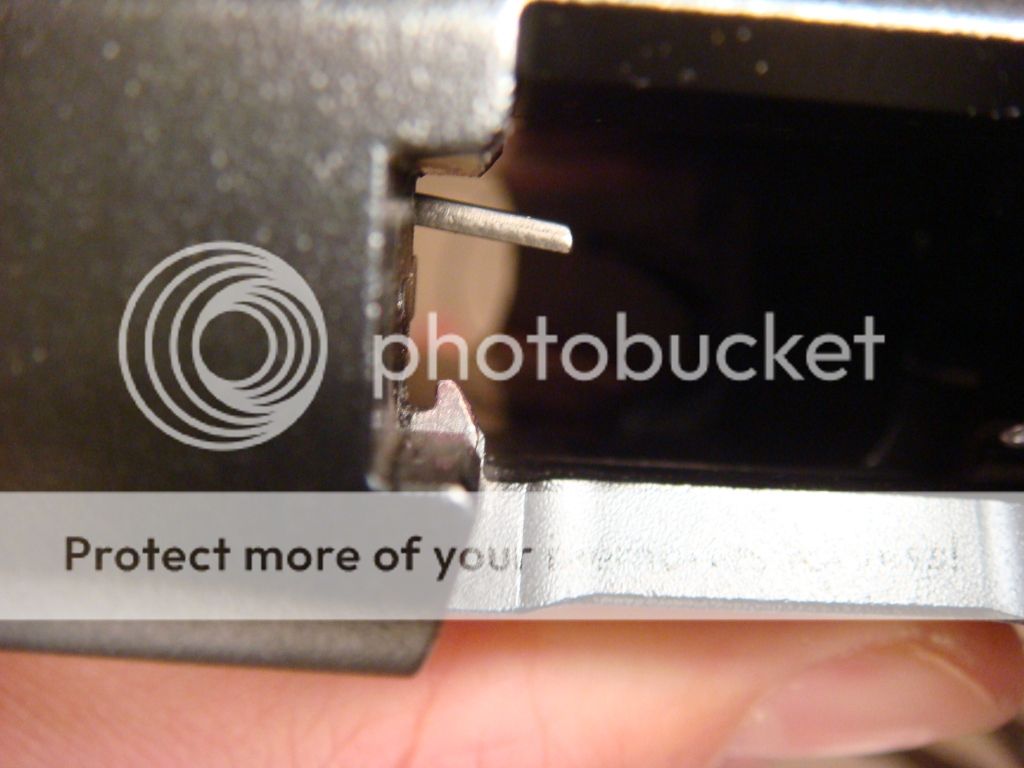

    I doubt its the ejection port height. If anything it is probably the extractor hook geometry or the ejector striking too high on the case.

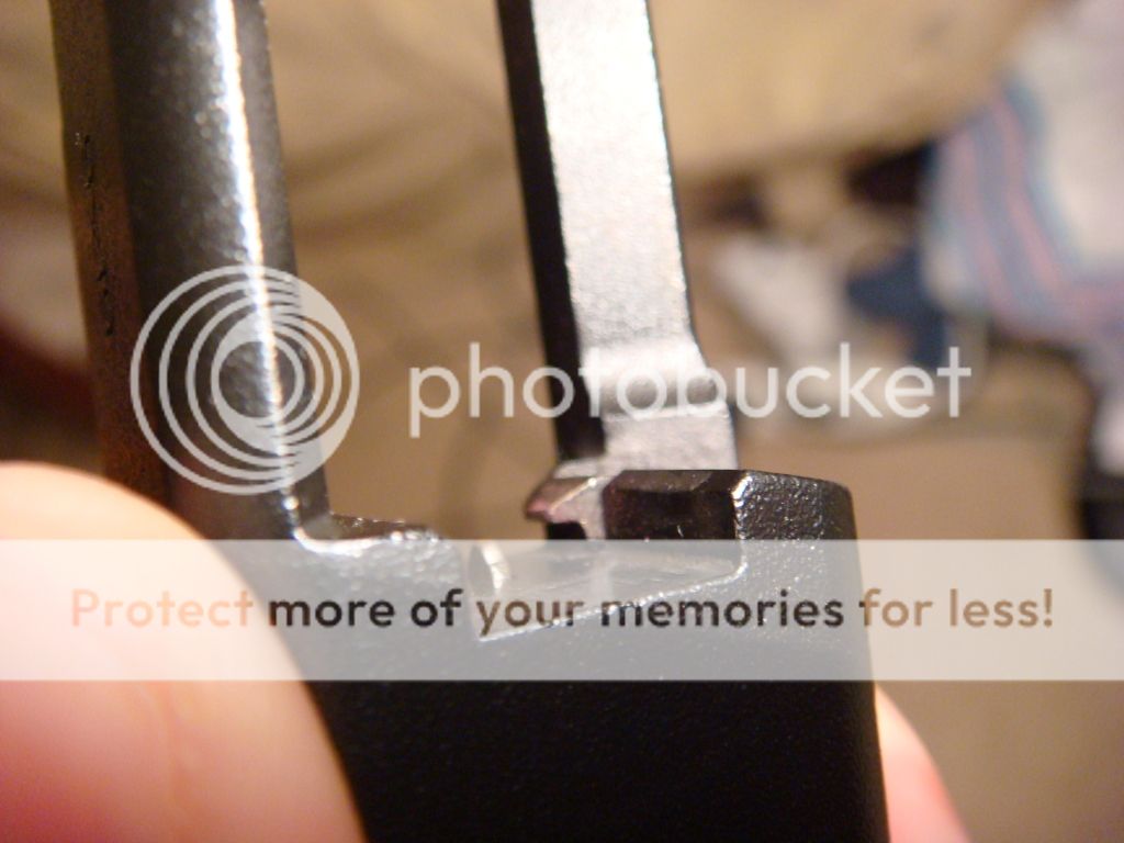

    Here are some pics of the extractor and ejector. As far as I can tell everything looks ok, but perhaps someone with more experience can see something else.
    Should I just replace both and see what happens? Are the parts readily available being from 08 and having a couple other variations out since the gen 4 debacle?
